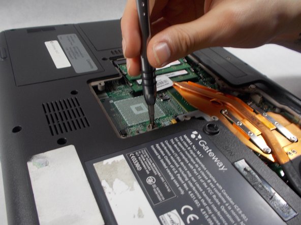

  4. Gateway MA7 CD/DVD Drive Replacement: crwdns2935265:04crwdnd2935265:01crwdnd2935265:02crwdne2935265:0 Gateway MA7 CD/DVD Drive Replacement: crwdns2935265:04crwdnd2935265:02crwdnd2935265:02crwdne2935265:0
    • Remove the following screws holding the DVD/CD drive in place:
    • One 6 mm Phillips #0

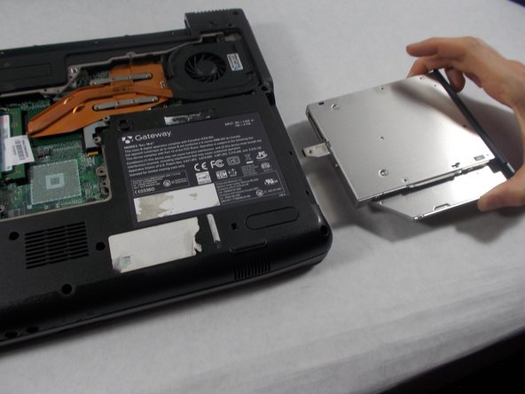

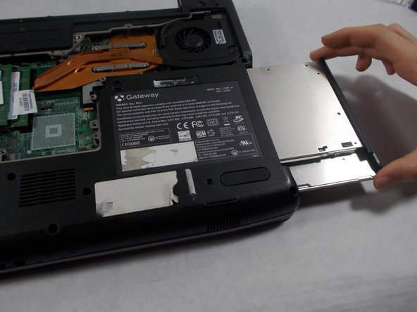

  5. Gateway MA7 CD/DVD Drive Replacement: crwdns2935265:05crwdnd2935265:01crwdnd2935265:01crwdne2935265:0
    • Use the edge of a plastic opening tool to push down on the metal latch preventing the drive from being pushed out.
    • While pressing down, push the metal latch out away from the laptop.
  6. Gateway MA7 CD/DVD Drive Replacement: crwdns2935265:06crwdnd2935265:01crwdnd2935265:03crwdne2935265:0 Gateway MA7 CD/DVD Drive Replacement: crwdns2935265:06crwdnd2935265:02crwdnd2935265:03crwdne2935265:0 Gateway MA7 CD/DVD Drive Replacement: crwdns2935265:06crwdnd2935265:03crwdnd2935265:03crwdne2935265:0
    • Once the drive has been pried out, you can pull the CD drive out.
