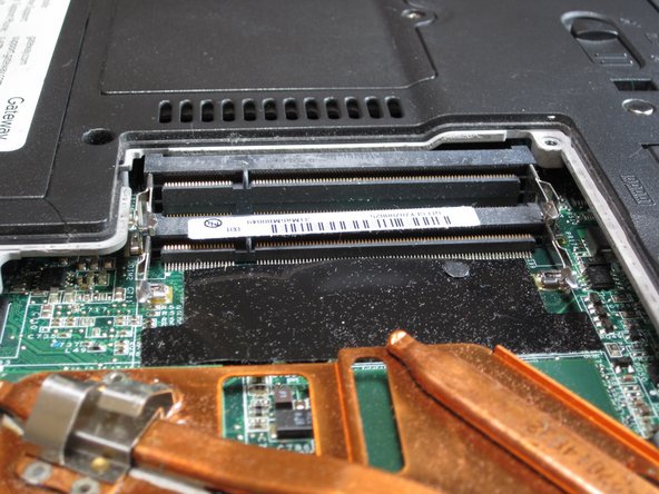

The RAM in this laptop can be accessed easily with very little disassembly. There are two slots that both accept PC2-5300S RAM.

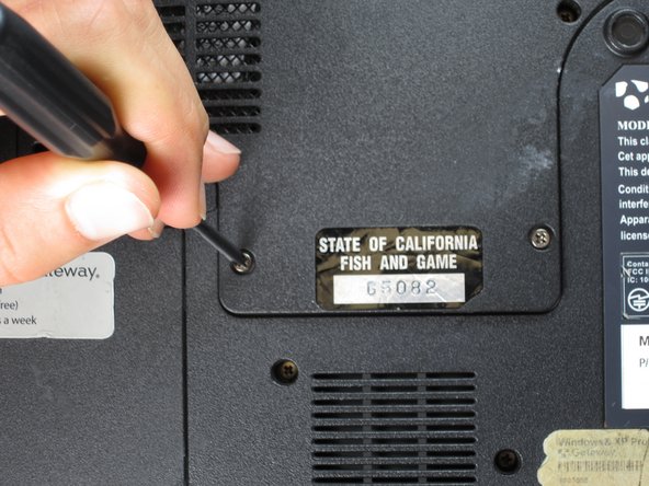

    1. Gateway MA6 Laptop RAM Replacement, RAM: crwdns2935265:03crwdnd2935265:01crwdnd2935265:02crwdne2935265:0 Gateway MA6 Laptop RAM Replacement, RAM: crwdns2935265:03crwdnd2935265:02crwdnd2935265:02crwdne2935265:0
      • Remove the seven 6 mm Phillips #0 screws from the back of the case.
      • Leave all the screws in the back plate and so you don't lose them.
    2. Gateway MA6 Laptop RAM Replacement: crwdns2935265:04crwdnd2935265:01crwdnd2935265:02crwdne2935265:0 Gateway MA6 Laptop RAM Replacement: crwdns2935265:04crwdnd2935265:02crwdnd2935265:02crwdne2935265:0
      • Pull upwards on the top of the back cover to remove it.

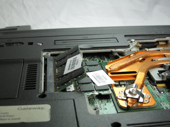

    3. Gateway MA6 Laptop RAM Replacement: crwdns2935265:05crwdnd2935265:01crwdnd2935265:03crwdne2935265:0 Gateway MA6 Laptop RAM Replacement: crwdns2935265:05crwdnd2935265:02crwdnd2935265:03crwdne2935265:0 Gateway MA6 Laptop RAM Replacement: crwdns2935265:05crwdnd2935265:03crwdnd2935265:03crwdne2935265:0
      • Pull outwards on the silver metal pins to release the upper RAM module.
      • The module will automatically lift up 30° after it has been released.
    4. Gateway MA6 Laptop RAM Replacement: crwdns2935265:06crwdnd2935265:01crwdnd2935265:02crwdne2935265:0 Gateway MA6 Laptop RAM Replacement: crwdns2935265:06crwdnd2935265:02crwdnd2935265:02crwdne2935265:0
      • Firmly grasp the outer portion of the RAM module, and pull it outward to remove it from the port.
      • Repeat the same process for the lower RAM module.
