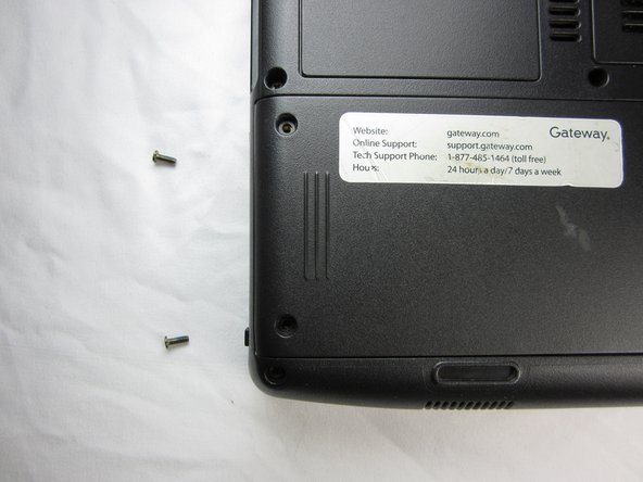

  3. Gateway MA6 Laptop Hard Drive Replacement, Hard Drive: crwdns2935265:03crwdnd2935265:01crwdnd2935265:02crwdne2935265:0 Gateway MA6 Laptop Hard Drive Replacement, Hard Drive: crwdns2935265:03crwdnd2935265:02crwdnd2935265:02crwdne2935265:0
    • Remove the two 9 mm Phillips #0 screws from the back of the hard drive cover.

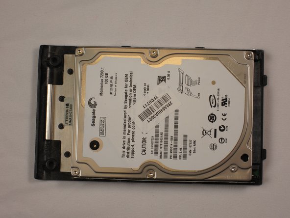

  4. Gateway MA6 Laptop Hard Drive Replacement: crwdns2935265:04crwdnd2935265:01crwdnd2935265:02crwdne2935265:0 Gateway MA6 Laptop Hard Drive Replacement: crwdns2935265:04crwdnd2935265:02crwdnd2935265:02crwdne2935265:0
    • Press thumb down firmly on the hard drive and pull outwards to the side.
