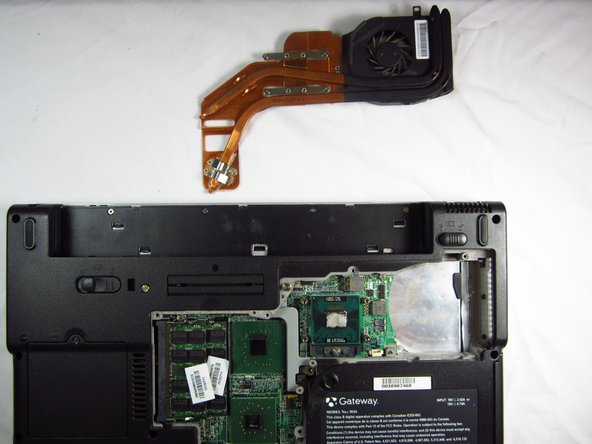

      • Loosen the four 9 mm Phillips #0 screws from the cooling assembly.
      • Leave all the screws in the cooling assembly so you don't lose them.

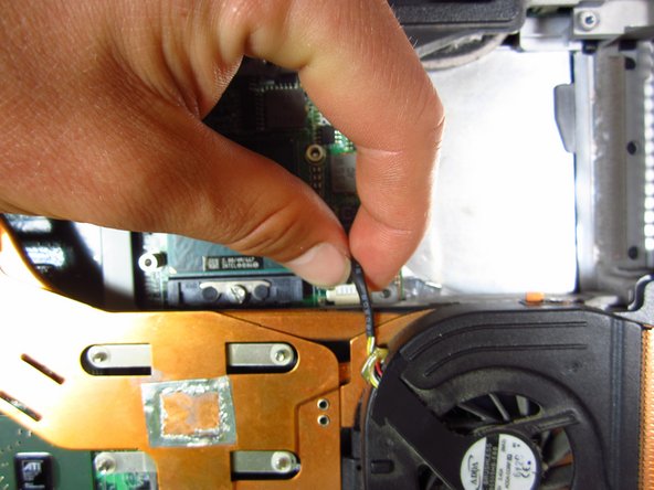

    4. Gateway MA6 Laptop Display Assembly Replacement: crwdns2935265:010crwdnd2935265:01crwdnd2935265:03crwdne2935265:0 Gateway MA6 Laptop Display Assembly Replacement: crwdns2935265:010crwdnd2935265:02crwdnd2935265:03crwdne2935265:0 Gateway MA6 Laptop Display Assembly Replacement: crwdns2935265:010crwdnd2935265:03crwdnd2935265:03crwdne2935265:0
      • Carefully lift up on the cooling assembly to avoid ripping the wire attaching it to the computer, and lay it upside down.
      • Carefully grab the wire attached to the computer and pull away from the port.
      • The cooling fan is now safe for removal.

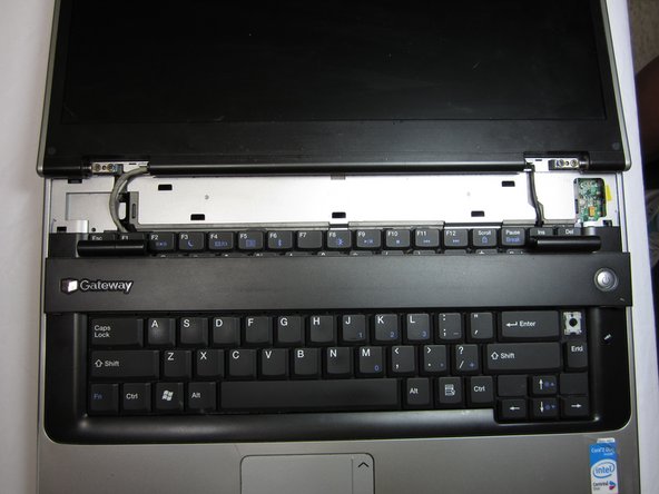

    5. Gateway MA6 Laptop Display Assembly Replacement: crwdns2935265:011crwdnd2935265:01crwdnd2935265:02crwdne2935265:0 Gateway MA6 Laptop Display Assembly Replacement: crwdns2935265:011crwdnd2935265:02crwdnd2935265:02crwdne2935265:0
      • With the computer oriented upright with the back facing towards you, remove the two 3 mm Phillips #0 screws.
      • Use the plastic opening tool to pry upwards on the bottom of the plastic piece covering the screw hole on the right side. Do the same for the left side.
      • The plastic piece will pop upwards, and a small gap, as shown, will appear. Ensure that it remains in this condition for the next step.

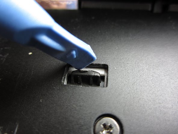

    6. Gateway MA6 Laptop Display Assembly Replacement: crwdns2935265:012crwdnd2935265:01crwdnd2935265:03crwdne2935265:0 Gateway MA6 Laptop Display Assembly Replacement: crwdns2935265:012crwdnd2935265:02crwdnd2935265:03crwdne2935265:0 Gateway MA6 Laptop Display Assembly Replacement: crwdns2935265:012crwdnd2935265:03crwdnd2935265:03crwdne2935265:0
      • Lay the computer down carefully on its keyboard, with the screen open.
      • There are 5 plastic pins that hold in the upper case cover. With the plastic opening tool, pry downwards on each of the plastic pins to pop them out one at a time.
      • The upper case will now be loose.
      • Flip the computer back over carefully, and remove the loosened upper case.

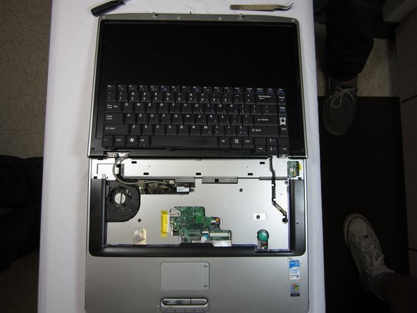

      • Flip the computer back over and open the screen. The keyboard will now be loose.
      • There is a ribbon cable connecting the keyboard to the computer, so do not pull it completely off to avoid tearing it.
      • Gently pull towards the screen on both sides of the keyboard and slide it upwards. Set it upside down onto the mousepad area.
      • Using the plastic opening tool, carefully pry between the black and white portion of the connection. It will pop out with moderate force.
      • Remove the keyboard.

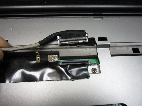

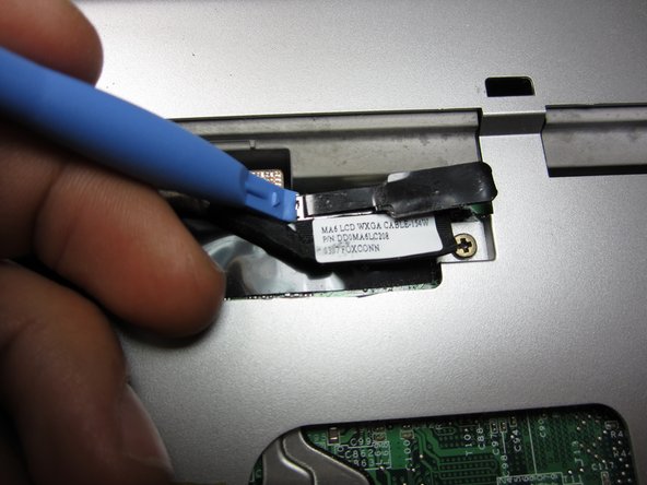

    9. Gateway MA6 Laptop Display Assembly Replacement: crwdns2935265:015crwdnd2935265:01crwdnd2935265:03crwdne2935265:0 Gateway MA6 Laptop Display Assembly Replacement: crwdns2935265:015crwdnd2935265:02crwdnd2935265:03crwdne2935265:0 Gateway MA6 Laptop Display Assembly Replacement: crwdns2935265:015crwdnd2935265:03crwdnd2935265:03crwdne2935265:0
      • Using your fingers, carefully pry upwards on the two gold prongs holding in the connection cable, to free it. These are located at the top left side of the case near the display hinge.
      • Using the plastic opening tool, pry upwards on the port connection for the display cable. It will release with minimal force.

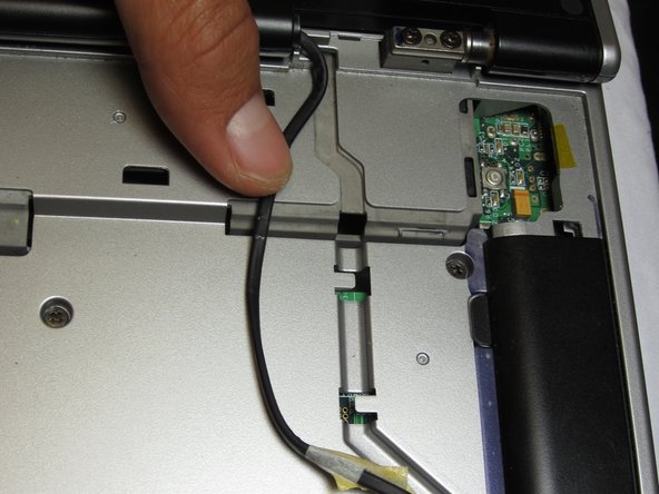

    10. Gateway MA6 Laptop Display Assembly Replacement: crwdns2935265:016crwdnd2935265:01crwdnd2935265:02crwdne2935265:0 Gateway MA6 Laptop Display Assembly Replacement: crwdns2935265:016crwdnd2935265:02crwdnd2935265:02crwdne2935265:0
      • Use the plastic opening tool to pry out the WiFi cable coming out of the right side of the display from the prongs that hold it in place.

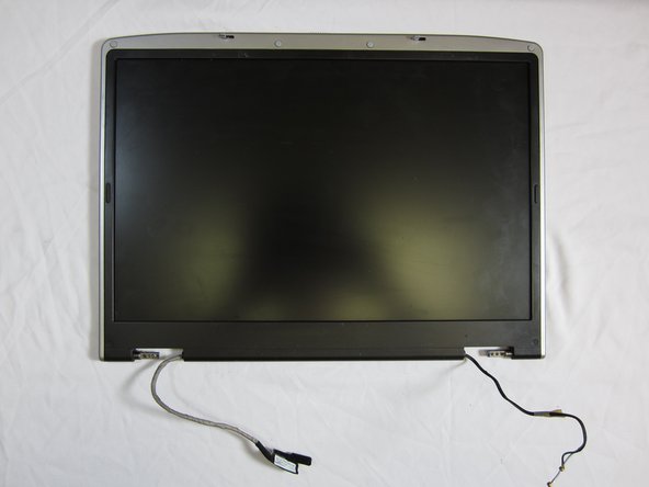

    11. Gateway MA6 Laptop Display Assembly Replacement: crwdns2935265:017crwdnd2935265:01crwdnd2935265:02crwdne2935265:0 Gateway MA6 Laptop Display Assembly Replacement: crwdns2935265:017crwdnd2935265:02crwdnd2935265:02crwdne2935265:0
      • Remove the two 5 mm Phillips #0 screws from the left side of the display hinge.
      • Repeat for the two 5 mm Phillips #0 screws on the right side.
      • Pull upwards on the sides of the display to fully separate it from the computer.
