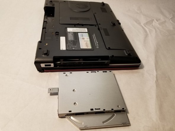

  3. Gateway M-2626u CD Drive Replacement, CD Drive: crwdns2935265:03crwdnd2935265:01crwdnd2935265:02crwdne2935265:0 Gateway M-2626u CD Drive Replacement, CD Drive: crwdns2935265:03crwdnd2935265:02crwdnd2935265:02crwdne2935265:0
    • Using the Phillips #1 screwdriver, remove the indicated 6mm screw holding the CD drive.
  4. Gateway M-2626u CD Drive Replacement: crwdns2935265:04crwdnd2935265:01crwdnd2935265:02crwdne2935265:0 Gateway M-2626u CD Drive Replacement: crwdns2935265:04crwdnd2935265:02crwdnd2935265:02crwdne2935265:0
    • Using the screwdriver, push the release button for the CD drive.
  5. Gateway M-2626u CD Drive Replacement: crwdns2935265:05crwdnd2935265:01crwdnd2935265:02crwdne2935265:0 Gateway M-2626u CD Drive Replacement: crwdns2935265:05crwdnd2935265:02crwdnd2935265:02crwdne2935265:0
    • Remove the CD drive from the device.
