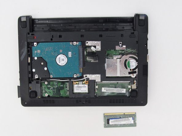

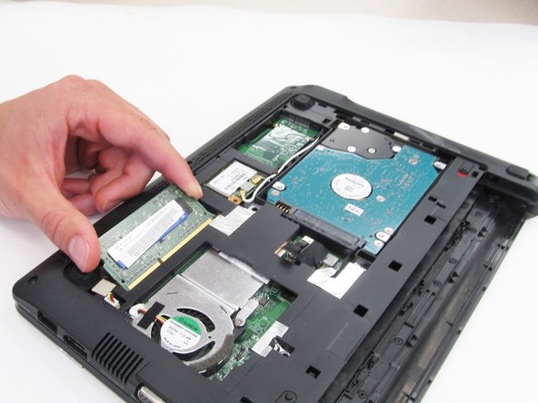

    1. Gateway Lt4004u RAM Replacement, RAM: crwdns2935265:010crwdnd2935265:01crwdnd2935265:03crwdne2935265:0 Gateway Lt4004u RAM Replacement, RAM: crwdns2935265:010crwdnd2935265:02crwdnd2935265:03crwdne2935265:0 Gateway Lt4004u RAM Replacement, RAM: crwdns2935265:010crwdnd2935265:03crwdnd2935265:03crwdne2935265:0
      • Locate the RAM in the bottom right corner. It is a thin green rectangle with a bar code sticker on top.
      • Using your thumbs, simultaneously press the two silver tabs on the outer edges of the RAM.
      • The laptop has been turned slightly in this picture to show the extraction.
      • Remove the RAM from the rest of the laptop.
