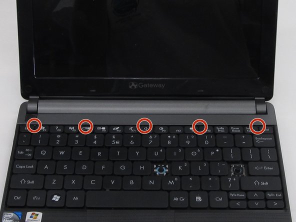

      • Open the laptop so that the screen and keyboard are facing you.
      • Identify the 5 tabs above the function keys in the crevice that attaches the keyboard to the main frame.
    2. Gateway Lt4004u Back Panel Replacement: crwdns2935265:04crwdnd2935265:01crwdnd2935265:03crwdne2935265:0 Gateway Lt4004u Back Panel Replacement: crwdns2935265:04crwdnd2935265:02crwdnd2935265:03crwdne2935265:0 Gateway Lt4004u Back Panel Replacement: crwdns2935265:04crwdnd2935265:03crwdnd2935265:03crwdne2935265:0
      • Use an opening pick to push each tab away from you.
      • Use an opening tool to push the middle tab until you hear a click. Begin to push the tool downward into the computer and slide the card along the length of the keyboard, as you overcome the five tabs.
      • A clicking sound is normal and no cause for alarm.

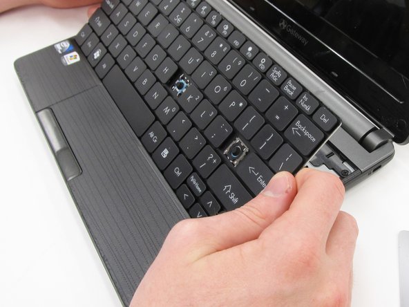

      • Begin to slide the plastic card under the top edge of the keyboard. You will hear popping sounds and the keyboard will eventually be released.
      • Carefully pry the keyboard from the main frame, starting at the top section.
      • Look at the intel sticker in this step and the next to orient your computer with the pictures.
    4. Gateway Lt4004u Back Panel Replacement: crwdns2935265:06crwdnd2935265:01crwdnd2935265:02crwdne2935265:0 Gateway Lt4004u Back Panel Replacement: crwdns2935265:06crwdnd2935265:02crwdnd2935265:02crwdne2935265:0
      • Look at the intel sticker in this step and the previous step to orient your computer with the pictures.
      • Unplug the thin blue connection piece beneath the keyboard. It may pop off on its own while you are prying off the keyboard.
      • The popping noise will not hurt the computer.
      • Once the thin blue plastic has been detached, remove the keyboard from the rest of the laptop.

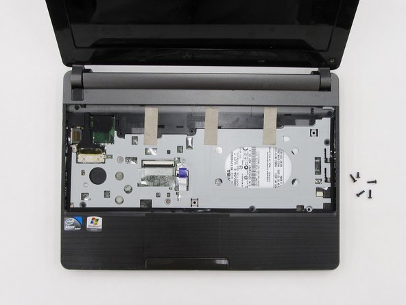

    1. Gateway Lt4004u Back Panel Replacement, Back Panel: crwdns2935265:07crwdnd2935265:01crwdnd2935265:03crwdne2935265:0 Gateway Lt4004u Back Panel Replacement, Back Panel: crwdns2935265:07crwdnd2935265:02crwdnd2935265:03crwdne2935265:0 Gateway Lt4004u Back Panel Replacement, Back Panel: crwdns2935265:07crwdnd2935265:03crwdnd2935265:03crwdne2935265:0
      • Locate and unscrew the five screws indicated by the red circles in the picture using a Phillip's #0 screwdriver. All of the screws are 8.0 mm, excluding the top right screw which is shorter. It should be 5.0mm.
      • Each screw should have the word "DOOR" engraved beside or above it.

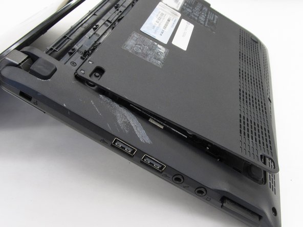

    2. Gateway Lt4004u Back Panel Replacement: crwdns2935265:08crwdnd2935265:01crwdnd2935265:03crwdne2935265:0 Gateway Lt4004u Back Panel Replacement: crwdns2935265:08crwdnd2935265:02crwdnd2935265:03crwdne2935265:0 Gateway Lt4004u Back Panel Replacement: crwdns2935265:08crwdnd2935265:03crwdnd2935265:03crwdne2935265:0
      • Hold the computer in your hands and use the tip of your screwdriver or a spudger to push through the bottom right hand hole left by the removed screw. This hole is shown in the picture within a red box.
      • The tip of the screwdriver will push against the bottom casing of the laptop and pop it away from the rest of the frame.
      • There will be a loud cracking noise as the bottom of the computer detaches. You are not breaking it!
    3. Gateway Lt4004u Back Panel Replacement: crwdns2935265:09crwdnd2935265:01crwdnd2935265:03crwdne2935265:0 Gateway Lt4004u Back Panel Replacement: crwdns2935265:09crwdnd2935265:02crwdnd2935265:03crwdne2935265:0 Gateway Lt4004u Back Panel Replacement: crwdns2935265:09crwdnd2935265:03crwdnd2935265:03crwdne2935265:0
      • Close the laptop and place it in front of you face-down with the hinge connecting the screen and keyboard away from you on the table. Pry the rest of the bottom casing away from the computer, exposing the inside.
      • Note that the laptop in this picture has both been placed upside down and rotated 180 degrees from the previous picture.
