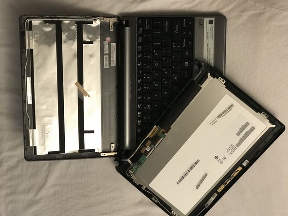

  4. Gateway LT41P10u Webcam Replacement, Monitor: crwdns2935265:04crwdnd2935265:01crwdnd2935265:02crwdne2935265:0 Gateway LT41P10u Webcam Replacement, Monitor: crwdns2935265:04crwdnd2935265:02crwdnd2935265:02crwdne2935265:0
    • Carefully use a spudger to separate the monitor from top panel.
    • Gently remove lower hooks from the hinges. (see second image)
  5. Gateway LT41P10u Webcam Replacement: crwdns2935265:05crwdnd2935265:01crwdnd2935265:02crwdne2935265:0 Gateway LT41P10u Webcam Replacement: crwdns2935265:05crwdnd2935265:02crwdnd2935265:02crwdne2935265:0
    • Once you completed separating the monitor from the top panel disconnect the cable shown here in red by raising the cable lock and pulling the wires away.
    • The second image is how it should look once completely disconnected.
  6. Gateway LT41P10u Webcam Replacement, Webcam: crwdns2935265:06crwdnd2935265:01crwdnd2935265:01crwdne2935265:0
    • Using a plastic spudger or fingers gently remove webcam hardware from front screen. A gentle heat source can be used to easily remove glued down parts.
    • Once webcam hardware is removed from front screen, it can be removed by hand from the wiring and replaced.
    • Perform these steps carefully as smaller parts are more likely to break.
