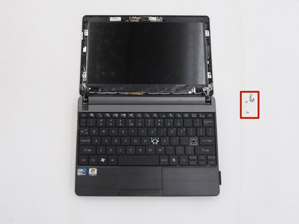

      • Open the laptop so that the screen and keyboard are facing you.
      • Remove the two screw covers at the bottom right and left corners of the screen using tweezers.
    2. Gateway LT4004u Screen Replacement: crwdns2935265:02crwdnd2935265:01crwdnd2935265:03crwdne2935265:0 Gateway LT4004u Screen Replacement: crwdns2935265:02crwdnd2935265:02crwdnd2935265:03crwdne2935265:0 Gateway LT4004u Screen Replacement: crwdns2935265:02crwdnd2935265:03crwdnd2935265:03crwdne2935265:0
      • Unscrew the two 5.0mm screws underneath the screen covers on the left and right side and remove them from the laptop. For this step and the following steps, use a Phillips #0 head screwdriver.

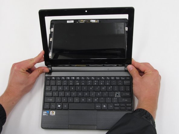

    3. Gateway LT4004u Screen Replacement: crwdns2935265:03crwdnd2935265:01crwdnd2935265:03crwdne2935265:0 Gateway LT4004u Screen Replacement: crwdns2935265:03crwdnd2935265:02crwdnd2935265:03crwdne2935265:0 Gateway LT4004u Screen Replacement: crwdns2935265:03crwdnd2935265:03crwdnd2935265:03crwdne2935265:0

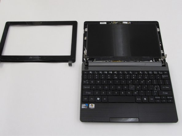

      • Once the two screws are removed, pry the screen casing away from the screen. You can use your fingernails or a tool such as tweezers to separate the screen casing from the backing.
      • Be prepared to hear cracking noises. These are expected.
      • Unhook the screen casing at the bottom of the screen from the central hinges on the left and right side connecting the screen casing to the keyboard.
      • Remove the screen casing.

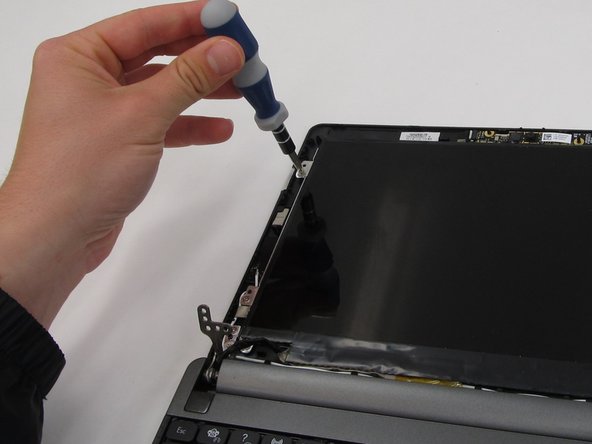

      • Once the screen casing is removed, unscrew the 8 screws surrounding the screen and remove them from the laptop. All 8 screws should measure 4.0mm long.
      • There is a single screw in each red indicator and two screws in each orange indicator, totaling to the eight screws.

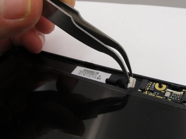

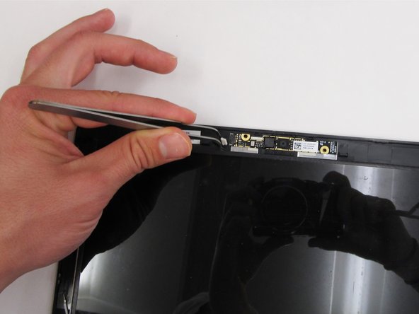

      • Unplug the webcam connection from the top of the laptop screen backing.

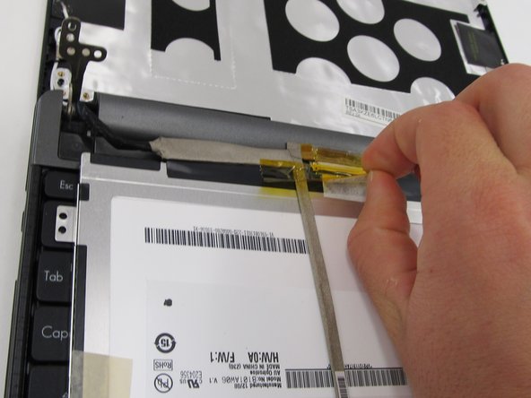

      • Flip the screen over so that it is lying on top of the keyboard.
      • Looking at the underside of the screen, remove the yellow tape and carefully remove the wires attaching the screen to the laptop.
    7. Gateway LT4004u Screen Replacement: crwdns2935265:07crwdnd2935265:01crwdnd2935265:01crwdne2935265:0
      • Remove the screen from the rest of the laptop.
