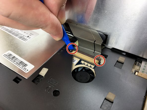

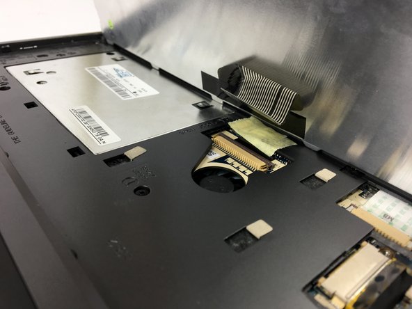

    • After releasing all 5 tabs, carefully lift the keyboard along its top edge until you see the ribbon that connects the keyboard to the motherboard.
    • Using a plastic opening tool, slide the 2 clips that hold the keyboard ribbon in place outward.
    • Carefully slide the ribbon out and you can now pull the keyboard away from the netbook.

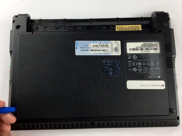

  6. Gateway LT2514u Wireless Card Replacement, Back Panel: crwdns2935265:06crwdnd2935265:01crwdnd2935265:01crwdne2935265:0
    • Using a Phillips #0 screwdriver, remove the four 6mm screws that secure the back access panel.

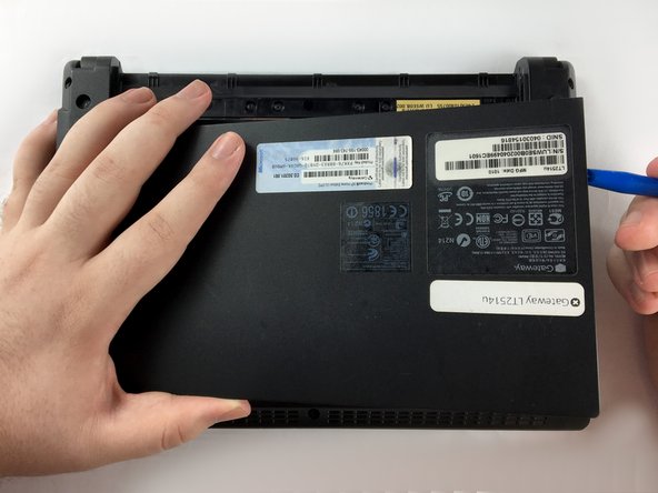

  7. Gateway LT2514u Wireless Card Replacement: crwdns2935265:07crwdnd2935265:01crwdnd2935265:03crwdne2935265:0 Gateway LT2514u Wireless Card Replacement: crwdns2935265:07crwdnd2935265:02crwdnd2935265:03crwdne2935265:0 Gateway LT2514u Wireless Card Replacement: crwdns2935265:07crwdnd2935265:03crwdnd2935265:03crwdne2935265:0
    • With the netbook lid closed, flip it over on its top. Work the head of a plastic opening tool into a corner of the back access panel until the corner pops up.
    • Keeping the head of the the plastic opening tool underneath the back access panel, work the tool in a sliding manner around the perimeter until all clips have popped.
    • Once all the clips have been released, pull the plate up and off.

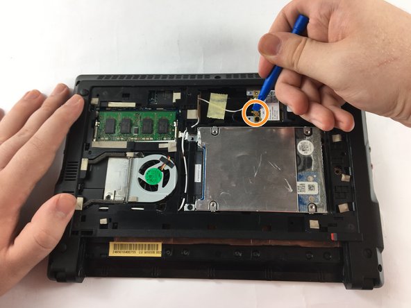

  8. Gateway LT2514u Wireless Card Replacement, Wireless Card: crwdns2935265:08crwdnd2935265:01crwdnd2935265:02crwdne2935265:0 Gateway LT2514u Wireless Card Replacement, Wireless Card: crwdns2935265:08crwdnd2935265:02crwdnd2935265:02crwdne2935265:0
    • Using a plastic opening tool (or something similar) pop the end of the white wire off of the wireless card.
    • Next, pop the end of the black wire off of the wireless card.
