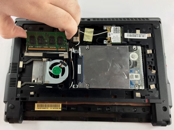

  6. Gateway LT2514u RAM Replacement, Back Panel: crwdns2935265:06crwdnd2935265:01crwdnd2935265:01crwdne2935265:0
    • Using a Phillips #0 screwdriver, remove the four 6mm screws that secure the back access panel.
  7. Gateway LT2514u RAM Replacement: crwdns2935265:07crwdnd2935265:01crwdnd2935265:03crwdne2935265:0 Gateway LT2514u RAM Replacement: crwdns2935265:07crwdnd2935265:02crwdnd2935265:03crwdne2935265:0 Gateway LT2514u RAM Replacement: crwdns2935265:07crwdnd2935265:03crwdnd2935265:03crwdne2935265:0
    • With the netbook lid closed, flip it over on its top. Work the head of a plastic opening tool into a corner of the back access panel until the corner pops up.
    • Keeping the head of the the plastic opening tool underneath the back access panel, work the tool in a sliding manner around the perimeter until all clips have popped.
    • Once all the clips have been released, pull the plate up and off.
  8. Gateway LT2514u RAM Replacement, RAM: crwdns2935265:08crwdnd2935265:01crwdnd2935265:02crwdne2935265:0 Gateway LT2514u RAM Replacement, RAM: crwdns2935265:08crwdnd2935265:02crwdnd2935265:02crwdne2935265:0
    • Push the 2 clips on the sides of the RAM card outward and the RAM card will pop up.
    • Grasp the RAM card by its outer edges and slide it out of its port.
