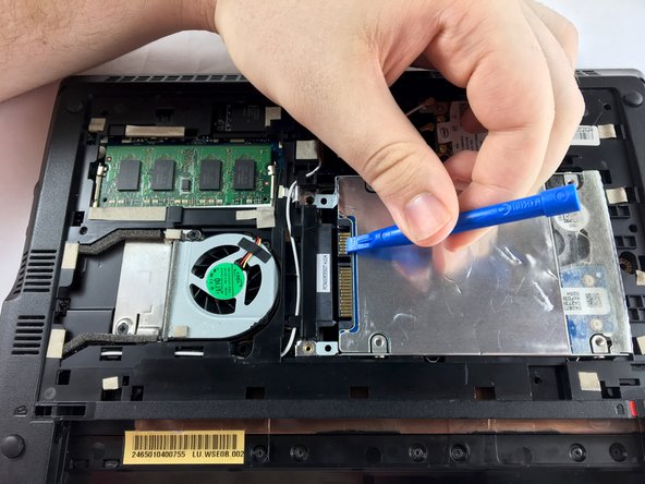

  8. Gateway LT2514u Hard Disk Drive Replacement, Hard Disk Drive: crwdns2935265:08crwdnd2935265:01crwdnd2935265:01crwdne2935265:0
    • Using a Phillips #0 screwdriver, remove the indicated M2x2mm screw.
  9. Gateway LT2514u Hard Disk Drive Replacement: crwdns2935265:09crwdnd2935265:01crwdnd2935265:02crwdne2935265:0 Gateway LT2514u Hard Disk Drive Replacement: crwdns2935265:09crwdnd2935265:02crwdnd2935265:02crwdne2935265:0
    • Use a plastic opening tool and slide the hard disk drive away from its port.
  10. Gateway LT2514u Hard Disk Drive Replacement: crwdns2935265:010crwdnd2935265:01crwdnd2935265:01crwdne2935265:0
    • There is a plastic tab on the HDD that will allow you to pull it out of the netbook.
