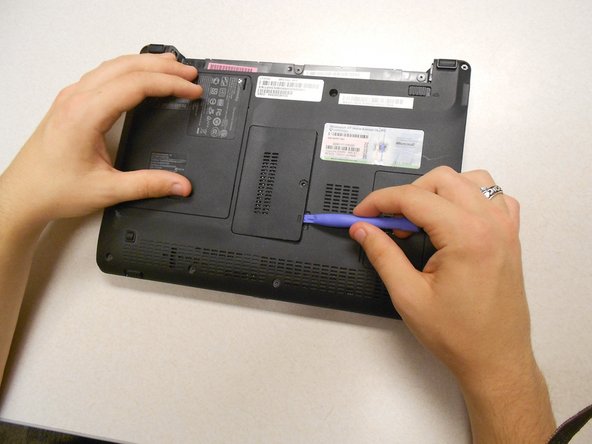

  2. Gateway KAV60 LT2016U RAM Replacement, RAM: crwdns2935265:02crwdnd2935265:01crwdnd2935265:01crwdne2935265:0
    • The RAM is located under this cover.
  3. Gateway KAV60 LT2016U RAM Replacement: crwdns2935265:03crwdnd2935265:01crwdnd2935265:03crwdne2935265:0 Gateway KAV60 LT2016U RAM Replacement: crwdns2935265:03crwdnd2935265:02crwdnd2935265:03crwdne2935265:0 Gateway KAV60 LT2016U RAM Replacement: crwdns2935265:03crwdnd2935265:03crwdnd2935265:03crwdne2935265:0
    • Using a Phillips #0 screwdriver, remove one (1) 5mm screw holding the cover in place.
    • Use a plastic opening tool to remove the cover.

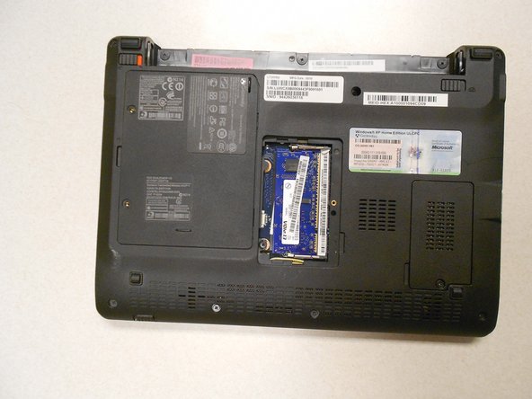

  4. Gateway KAV60 LT2016U RAM Replacement: crwdns2935265:04crwdnd2935265:01crwdnd2935265:02crwdne2935265:0 Gateway KAV60 LT2016U RAM Replacement: crwdns2935265:04crwdnd2935265:02crwdnd2935265:02crwdne2935265:0
    • Unlock the RAM by pinching the metal clamps that keep the RAM in place.
    • Remove the RAM while the metal clamps are disengaged.
