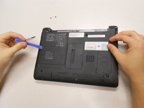

  3. Gateway KAV60 LT2016U Netbook Hard Drive Replacement: crwdns2935265:03crwdnd2935265:01crwdnd2935265:01crwdne2935265:0
    • Lift off the cover with the plastic opener.

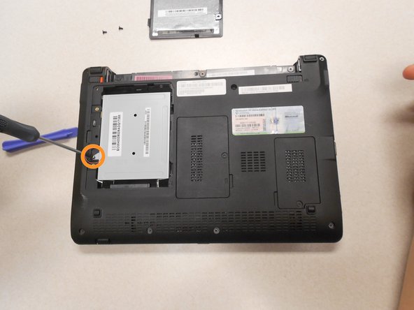

  4. Gateway KAV60 LT2016U Netbook Hard Drive Replacement: crwdns2935265:04crwdnd2935265:01crwdnd2935265:01crwdne2935265:0
    • Remove the one screw holding the hard drive in place with the same screw driver.

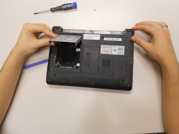

  5. Gateway KAV60 LT2016U Netbook Hard Drive Replacement: crwdns2935265:05crwdnd2935265:01crwdnd2935265:01crwdne2935265:0
    • Slide the hard drive up and remove it from the laptop.
