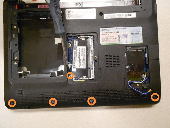

    • Remove all 11 of the screw shown on the bottom of the lap top using the specified screw driver.

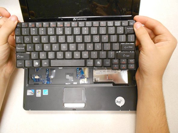

    • Lift off the keyboard by doing exactly what is shown in the first picture. Get the head of the plastic opening tool under and then wedge it out.

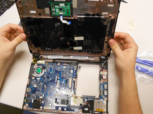

    • Remove the 5 circled screws with the Phillips #0 screw driver.

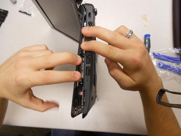

    • Carefully separate the back cover from the front either using your hands or a plastic opening tool.

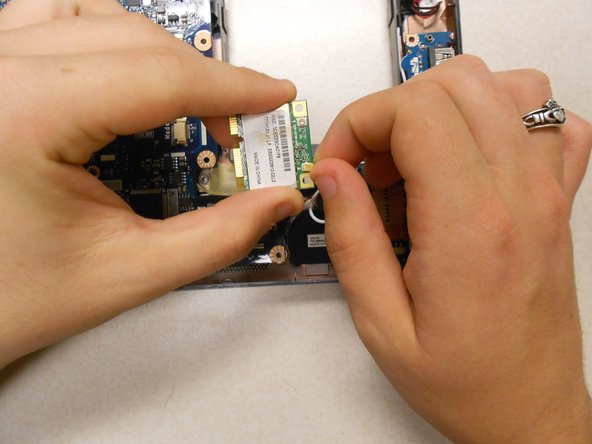

    • Unscrew this 1 screw to remove the wifi card.
    • Then unplug the wires it is attached to and take it out.

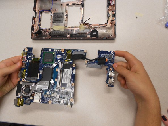

    • Use the phillps #00 screw driver to remove these 3 small scows so the motherboard can be removed.
    • Then remove it from the base of th computer.

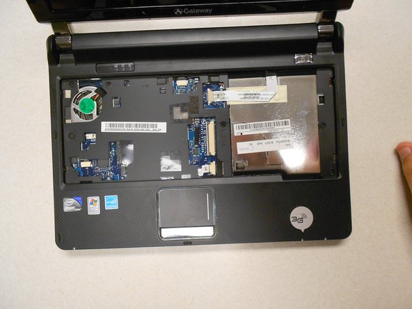

  10. Gateway KAV60 LT2016U Netbook Cooling Fan Replacement: crwdns2935265:010crwdnd2935265:01crwdnd2935265:01crwdne2935265:0
    • Use the Phillips #00 screw driver to remove the 4 circled screws.
  11. Gateway KAV60 LT2016U Netbook Cooling Fan Replacement: crwdns2935265:011crwdnd2935265:01crwdnd2935265:01crwdne2935265:0
    • Disconnect the wires from the motherboard.
    • The fan should now be fully disconnected and ready to replace.
