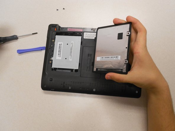

    • Remove the two (2) 5mm screws holding the cover down using the Phillips #0 screwdriver.
  4. Gateway KAV60 LT2016U Hard Drive Replacement: crwdns2935265:04crwdnd2935265:01crwdnd2935265:02crwdne2935265:0 Gateway KAV60 LT2016U Hard Drive Replacement: crwdns2935265:04crwdnd2935265:02crwdnd2935265:02crwdne2935265:0
    • Use a plastic opening tool to lift the cover.
  5. Gateway KAV60 LT2016U Hard Drive Replacement: crwdns2935265:05crwdnd2935265:01crwdnd2935265:01crwdne2935265:0
    • Using a Phillips #0 screwdriver, remove a third 5mm screw that holds the second cover that is directly protecting the hard drive.
  6. Gateway KAV60 LT2016U Hard Drive Replacement: crwdns2935265:06crwdnd2935265:01crwdnd2935265:03crwdne2935265:0 Gateway KAV60 LT2016U Hard Drive Replacement: crwdns2935265:06crwdnd2935265:02crwdnd2935265:03crwdne2935265:0 Gateway KAV60 LT2016U Hard Drive Replacement: crwdns2935265:06crwdnd2935265:03crwdnd2935265:03crwdne2935265:0
    • Slide the silver cover up; the hole on the cover and the hole for the screw will no longer match up.
    • Lift the silver cover; this will expose the hard drive.
