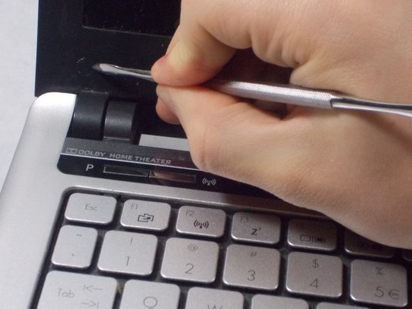

  8. Gateway ID49C07U Screen Replacement: crwdns2935265:08crwdnd2935265:01crwdnd2935265:01crwdne2935265:0
    • Use the small metal spudger to start separating the front plastic cover from the back plastic cover

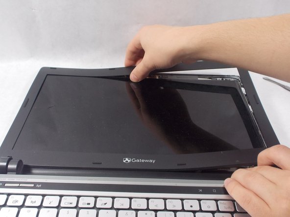

  9. Gateway ID49C07U Screen Replacement: crwdns2935265:09crwdnd2935265:01crwdnd2935265:03crwdne2935265:0 Gateway ID49C07U Screen Replacement: crwdns2935265:09crwdnd2935265:02crwdnd2935265:03crwdne2935265:0 Gateway ID49C07U Screen Replacement: crwdns2935265:09crwdnd2935265:03crwdnd2935265:03crwdne2935265:0
    • Once there is enough room for you to fit your hand underneath the top plastic cover you can start pealing it back. It will make a lot of popping noises as it unclips when you separate it.

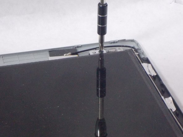

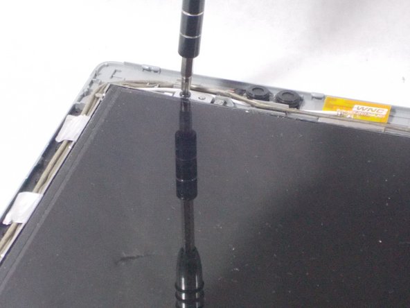

  10. Gateway ID49C07U Screen Replacement: crwdns2935265:010crwdnd2935265:01crwdnd2935265:03crwdne2935265:0 Gateway ID49C07U Screen Replacement: crwdns2935265:010crwdnd2935265:02crwdnd2935265:03crwdne2935265:0 Gateway ID49C07U Screen Replacement: crwdns2935265:010crwdnd2935265:03crwdnd2935265:03crwdne2935265:0
    • Once the plastic cover is off locate the 4 screws in the corners of the screen and unscrew them

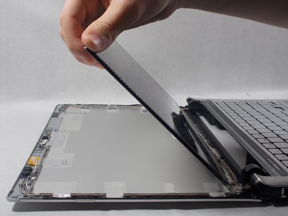

  11. Gateway ID49C07U Screen Replacement: crwdns2935265:011crwdnd2935265:01crwdnd2935265:02crwdne2935265:0 Gateway ID49C07U Screen Replacement: crwdns2935265:011crwdnd2935265:02crwdnd2935265:02crwdne2935265:0
    • After the screws are out gently flip the screen over onto the keyboard
