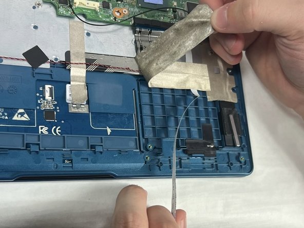

    • Flick open the bracket and peel back the white cable.
  7. Gateway GWTC116-2BL Touchpad Replacement: crwdns2935265:07crwdnd2935265:01crwdnd2935265:02crwdne2935265:0 Gateway GWTC116-2BL Touchpad Replacement: crwdns2935265:07crwdnd2935265:02crwdnd2935265:02crwdne2935265:0
    • Peel the metallic tape off of the casing.
  8. Gateway GWTC116-2BL Touchpad Replacement: crwdns2935265:08crwdnd2935265:01crwdnd2935265:01crwdne2935265:0
    • Peel off the smaller piece of metallic tape that was underneath the other tape.
