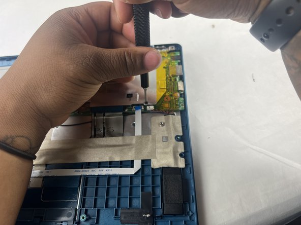

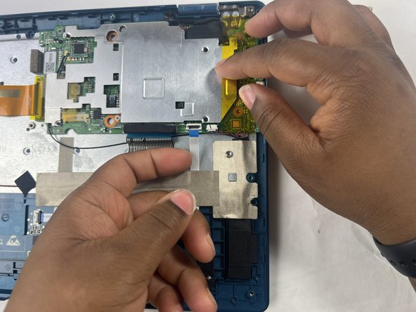

  8. Gateway GWTC116-2BL Motherboard Replacement: crwdns2935265:08crwdnd2935265:01crwdnd2935265:02crwdne2935265:0 Gateway GWTC116-2BL Motherboard Replacement: crwdns2935265:08crwdnd2935265:02crwdnd2935265:02crwdne2935265:0
    • Remove the four 3.0 mm Phillips #00 screws located on the motherboard casing.

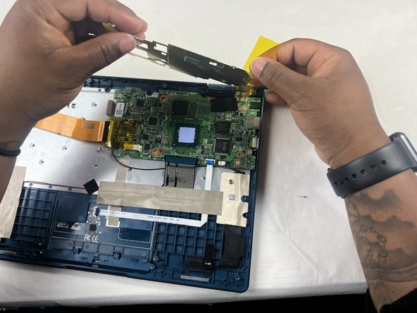

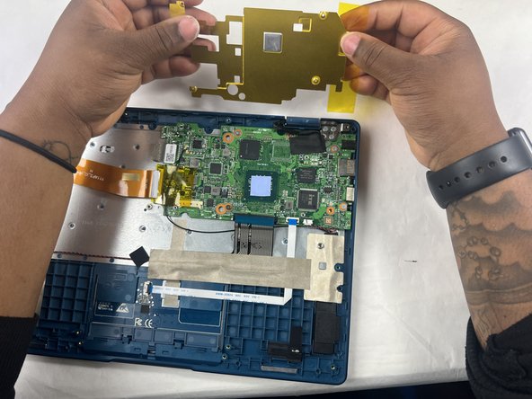

  9. Gateway GWTC116-2BL Motherboard Replacement: crwdns2935265:09crwdnd2935265:01crwdnd2935265:03crwdne2935265:0 Gateway GWTC116-2BL Motherboard Replacement: crwdns2935265:09crwdnd2935265:02crwdnd2935265:03crwdne2935265:0 Gateway GWTC116-2BL Motherboard Replacement: crwdns2935265:09crwdnd2935265:03crwdnd2935265:03crwdne2935265:0
    • Peel the yellow tape off of the casing.
    • Lift the casing off of the motherboard.

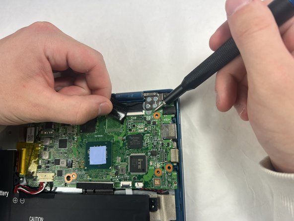

  11. Gateway GWTC116-2BL Motherboard Replacement: crwdns2935265:011crwdnd2935265:01crwdnd2935265:02crwdne2935265:0 Gateway GWTC116-2BL Motherboard Replacement: crwdns2935265:011crwdnd2935265:02crwdnd2935265:02crwdne2935265:0
    • Peel off the black piece of tape covering the display cable.
  12. Gateway GWTC116-2BL Motherboard Replacement: crwdns2935265:012crwdnd2935265:01crwdnd2935265:02crwdne2935265:0 Gateway GWTC116-2BL Motherboard Replacement: crwdns2935265:012crwdnd2935265:02crwdnd2935265:02crwdne2935265:0
    • Flick open the bracket securing the display cable and disconnect the cable from the motherboard.
