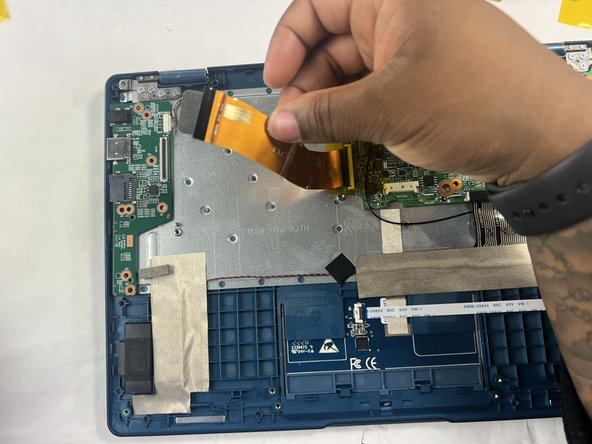

    • Flick open the bracket that connects the motherboard and daughterboard.
    • Remove the connector strip.
  9. Gateway GWTC116-2BL Daughterboard Replacement: crwdns2935265:09crwdnd2935265:01crwdnd2935265:01crwdne2935265:0
    • Remove the daughterboard from the base of the computer.
