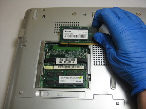

      • Flip the computer over so that the bottom of your device is face up.
    2. Gateway 600YGR RAM  Replacement: crwdns2935265:02crwdnd2935265:01crwdnd2935265:03crwdne2935265:0 Gateway 600YGR RAM  Replacement: crwdns2935265:02crwdnd2935265:02crwdnd2935265:03crwdne2935265:0 Gateway 600YGR RAM  Replacement: crwdns2935265:02crwdnd2935265:03crwdnd2935265:03crwdne2935265:0
      • Use a Philips head screwdriver and the PH1 bit to remove the indicated 5.35mm screw.
      • Remove the cover panel.
    3. Gateway 600YGR RAM  Replacement: crwdns2935265:03crwdnd2935265:01crwdnd2935265:03crwdne2935265:0 Gateway 600YGR RAM  Replacement: crwdns2935265:03crwdnd2935265:02crwdnd2935265:03crwdne2935265:0 Gateway 600YGR RAM  Replacement: crwdns2935265:03crwdnd2935265:03crwdnd2935265:03crwdne2935265:0

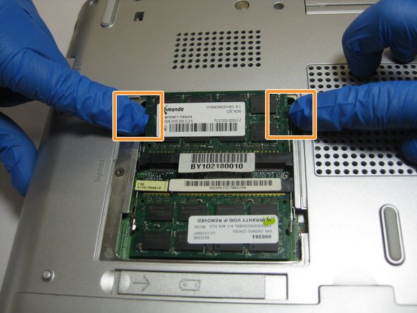

      • Locate the indicated tabs on the edges of the top RAM board.
      • Pull the tabs outward and the RAM board will release.
      • Remove the RAM board.

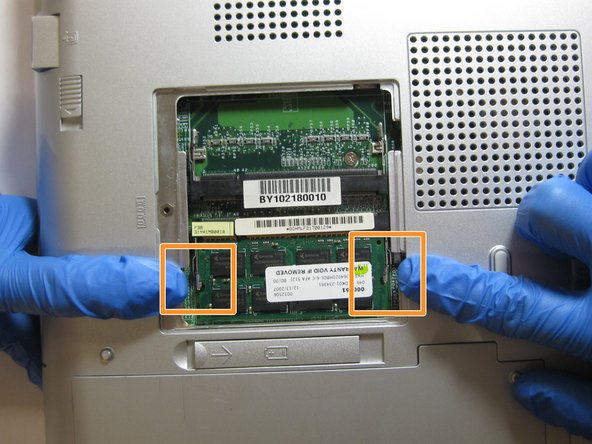

    4. Gateway 600YGR RAM  Replacement: crwdns2935265:04crwdnd2935265:01crwdnd2935265:02crwdne2935265:0 Gateway 600YGR RAM  Replacement: crwdns2935265:04crwdnd2935265:02crwdnd2935265:02crwdne2935265:0
      • Locate the indicated tabs on the edges of the bottom RAM board.
      • Pull the tabs outward.
    5. Gateway 600YGR RAM  Replacement: crwdns2935265:05crwdnd2935265:01crwdnd2935265:02crwdne2935265:0 Gateway 600YGR RAM  Replacement: crwdns2935265:05crwdnd2935265:02crwdnd2935265:02crwdne2935265:0
      • You have now successfully removed the RAM boards.
