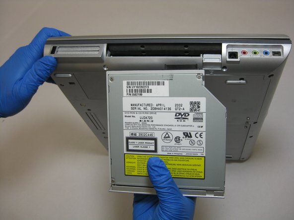

      • Turn your device over so the bottom is face up and locate the DVD disc drive.
    2. Gateway 600YGR  DVD Disc Drive Replacement: crwdns2935265:02crwdnd2935265:01crwdnd2935265:02crwdne2935265:0 Gateway 600YGR  DVD Disc Drive Replacement: crwdns2935265:02crwdnd2935265:02crwdnd2935265:02crwdne2935265:0
      • Slide the tab indicated in red to the right.
      • Simultaneously push the button indicated in orange.
      • The DVD disk drive should partially eject itself.
    3. Gateway 600YGR  DVD Disc Drive Replacement: crwdns2935265:03crwdnd2935265:01crwdnd2935265:03crwdne2935265:0 Gateway 600YGR  DVD Disc Drive Replacement: crwdns2935265:03crwdnd2935265:02crwdnd2935265:03crwdne2935265:0 Gateway 600YGR  DVD Disc Drive Replacement: crwdns2935265:03crwdnd2935265:03crwdnd2935265:03crwdne2935265:0
      • Pull the DVD disk drive out.
      • For reinstallation slide new DVD disc drive into slot until a click is heard.
