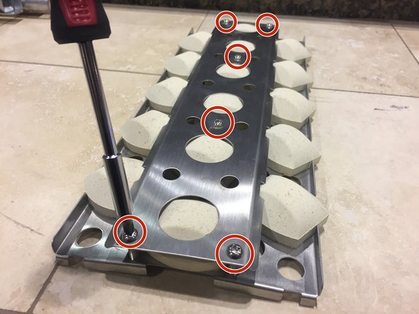

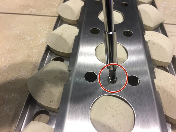

  3. Gas Grill Ceramic Briquettes Replacement, Unscrew Briquette Casing: crwdns2935265:03crwdnd2935265:01crwdnd2935265:03crwdne2935265:0 Gas Grill Ceramic Briquettes Replacement, Unscrew Briquette Casing: crwdns2935265:03crwdnd2935265:02crwdnd2935265:03crwdne2935265:0 Gas Grill Ceramic Briquettes Replacement, Unscrew Briquette Casing: crwdns2935265:03crwdnd2935265:03crwdnd2935265:03crwdne2935265:0
    • Locate the six screws located on top of the ceramic briquette casing and unscrew them using your phillips head screwdriver.
    • A small container is recommended to keep the screws together

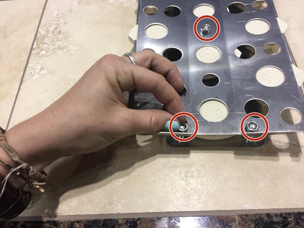

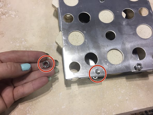

  4. Gas Grill Ceramic Briquettes Replacement, Unscrew Washers: crwdns2935265:04crwdnd2935265:01crwdnd2935265:03crwdne2935265:0 Gas Grill Ceramic Briquettes Replacement, Unscrew Washers: crwdns2935265:04crwdnd2935265:02crwdnd2935265:03crwdne2935265:0 Gas Grill Ceramic Briquettes Replacement, Unscrew Washers: crwdns2935265:04crwdnd2935265:03crwdnd2935265:03crwdne2935265:0
    • Using your hands, gently unscrew washers from the back of the casing.
    • A small container is recommended to keep the washers together

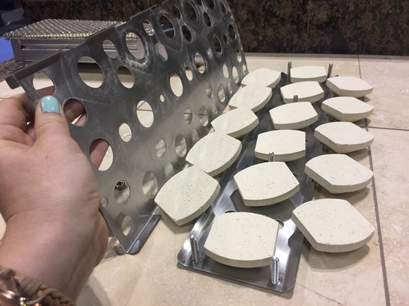

  5. Gas Grill Ceramic Briquettes Replacement, Separate Two Pieces: crwdns2935265:05crwdnd2935265:01crwdnd2935265:03crwdne2935265:0 Gas Grill Ceramic Briquettes Replacement, Separate Two Pieces: crwdns2935265:05crwdnd2935265:02crwdnd2935265:03crwdne2935265:0 Gas Grill Ceramic Briquettes Replacement, Separate Two Pieces: crwdns2935265:05crwdnd2935265:03crwdnd2935265:03crwdne2935265:0
    • Separate the front and back metal casings surrounding the briquettes.

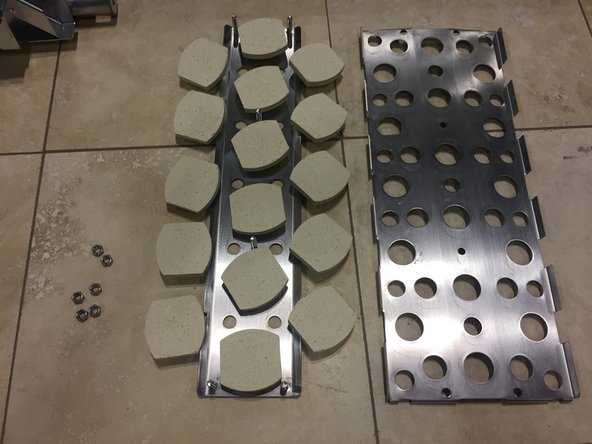

  6. Gas Grill Ceramic Briquettes Replacement, Remove Old Briquettes: crwdns2935265:06crwdnd2935265:01crwdnd2935265:01crwdne2935265:0
    • Take out old and used briquettes and dispose of them. (They will probably be black and tarnished)
  7. Gas Grill Ceramic Briquettes Replacement, Replace With New Ones: crwdns2935265:07crwdnd2935265:01crwdnd2935265:01crwdne2935265:0
    • Take 16 new ceramic briquettes out and carefully align them inside the casing.
    • Be sure to pay attention to where you place them, as some should be straight and some diagonal for the casing to close back correctly.
