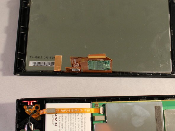

  3. Garmin nuviCam LMTHD Speaker Replacement: crwdns2935265:03crwdnd2935265:01crwdnd2935265:01crwdne2935265:0
    • Disconnect the black and red wire from the screen.
  4. Garmin nuviCam LMTHD Speaker Replacement: crwdns2935265:04crwdnd2935265:01crwdnd2935265:02crwdne2935265:0 Garmin nuviCam LMTHD Speaker Replacement: crwdns2935265:04crwdnd2935265:02crwdnd2935265:02crwdne2935265:0
    • Disconnect the orange strip by flipping up the connector with a plastic opening tool and sliding the cable out.

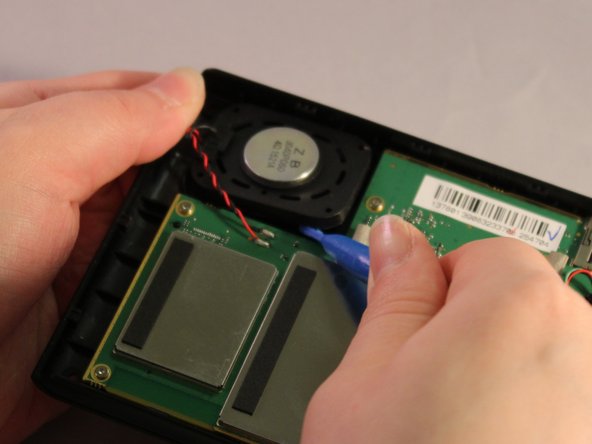

  5. Garmin nuviCam LMTHD Speaker Replacement, Speaker: crwdns2935265:05crwdnd2935265:01crwdnd2935265:02crwdne2935265:0 Garmin nuviCam LMTHD Speaker Replacement, Speaker: crwdns2935265:05crwdnd2935265:02crwdnd2935265:02crwdne2935265:0
    • Locate the speaker in the corner opposite of the dashcam.
    • Pry speaker out of device using a plastic opening tool.
