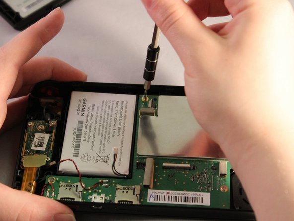

    • Remove silver plate from motherboard.
  10. Garmin nuviCam LMTHD Motherboard Replacement: crwdns2935265:010crwdnd2935265:01crwdnd2935265:02crwdne2935265:0 Garmin nuviCam LMTHD Motherboard Replacement: crwdns2935265:010crwdnd2935265:02crwdnd2935265:02crwdne2935265:0
    • Remove all six 5.74mm screws from motherboard using the T4 screw bit.
  11. Garmin nuviCam LMTHD Motherboard Replacement: crwdns2935265:011crwdnd2935265:01crwdnd2935265:02crwdne2935265:0 Garmin nuviCam LMTHD Motherboard Replacement: crwdns2935265:011crwdnd2935265:02crwdnd2935265:02crwdne2935265:0
    • Lift motherboard out of device using plastic opening tools.
