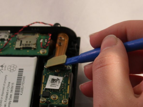

  5. Garmin nuviCam LMTHD Dash Camera Replacement, Dash Camera: crwdns2935265:05crwdnd2935265:01crwdnd2935265:02crwdne2935265:0 Garmin nuviCam LMTHD Dash Camera Replacement, Dash Camera: crwdns2935265:05crwdnd2935265:02crwdnd2935265:02crwdne2935265:0
    • Remove green strip of tape over orange strip.
    • Disconnect orange strip from device using plastic opening tools.

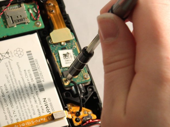

  6. Garmin nuviCam LMTHD Dash Camera Replacement: crwdns2935265:06crwdnd2935265:01crwdnd2935265:02crwdne2935265:0 Garmin nuviCam LMTHD Dash Camera Replacement: crwdns2935265:06crwdnd2935265:02crwdnd2935265:02crwdne2935265:0
    • Unscrew six 5.74mm silver screws using the T4 screw bit.

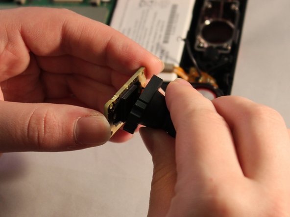

  7. Garmin nuviCam LMTHD Dash Camera Replacement: crwdns2935265:07crwdnd2935265:01crwdnd2935265:03crwdne2935265:0 Garmin nuviCam LMTHD Dash Camera Replacement: crwdns2935265:07crwdnd2935265:02crwdnd2935265:03crwdne2935265:0 Garmin nuviCam LMTHD Dash Camera Replacement: crwdns2935265:07crwdnd2935265:03crwdnd2935265:03crwdne2935265:0
    • Pop out green plate using plastic prying tool.
