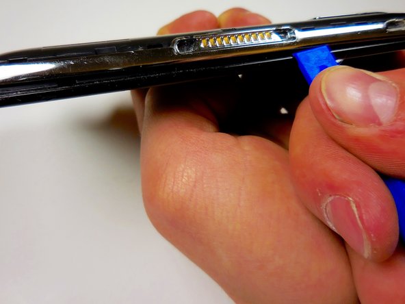

  2. Garmin nüvi 3590 LMT Speaker Replacement: crwdns2935265:02crwdnd2935265:01crwdnd2935265:01crwdne2935265:0
    • Use the plastic opening tool to separate the tabs on the black back cover of the device by leveraging the tool against the frame around the perimeter of the device.

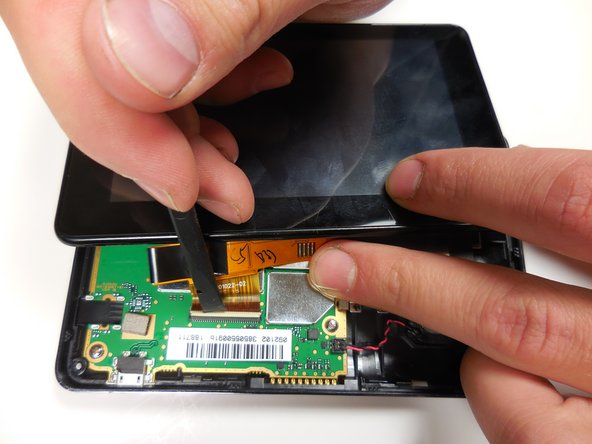

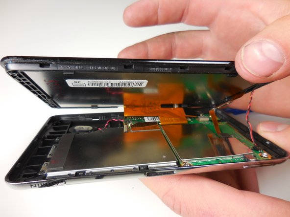

  7. Garmin nüvi 3590 LMT Speaker Replacement: crwdns2935265:07crwdnd2935265:01crwdnd2935265:03crwdne2935265:0 Garmin nüvi 3590 LMT Speaker Replacement: crwdns2935265:07crwdnd2935265:02crwdnd2935265:03crwdne2935265:0 Garmin nüvi 3590 LMT Speaker Replacement: crwdns2935265:07crwdnd2935265:03crwdnd2935265:03crwdne2935265:0
    • Leverage the plastic opening tool to pop the tabs between the black screen and the metal frame. Carefully work around the perimeter of the frame.
    • Do not forcibly separate the two pieces after the tabs have been popped as there are connections between the two pieces that could be torn.
  8. Garmin nüvi 3590 LMT Speaker Replacement: crwdns2935265:08crwdnd2935265:01crwdnd2935265:01crwdne2935265:0
    • Using your fingers, remove the red and black wire from the back of the screen. This is the connection to the light sensor, not the speaker.

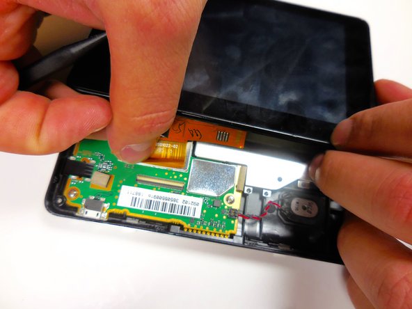

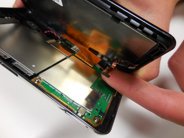

  10. Garmin nüvi 3590 LMT Speaker Replacement: crwdns2935265:010crwdnd2935265:01crwdnd2935265:03crwdne2935265:0 Garmin nüvi 3590 LMT Speaker Replacement: crwdns2935265:010crwdnd2935265:02crwdnd2935265:03crwdne2935265:0 Garmin nüvi 3590 LMT Speaker Replacement: crwdns2935265:010crwdnd2935265:03crwdnd2935265:03crwdne2935265:0
    • For the larger orange connection, there is a white tab holding the connection to the circuit board.
    • Lift this tab gently with the wide tipped tweezers or the plastic spudger and remove the orange connection from the circuit board.
    • After the white tab is lifted, slide the ribbon connector out from the circuit board.

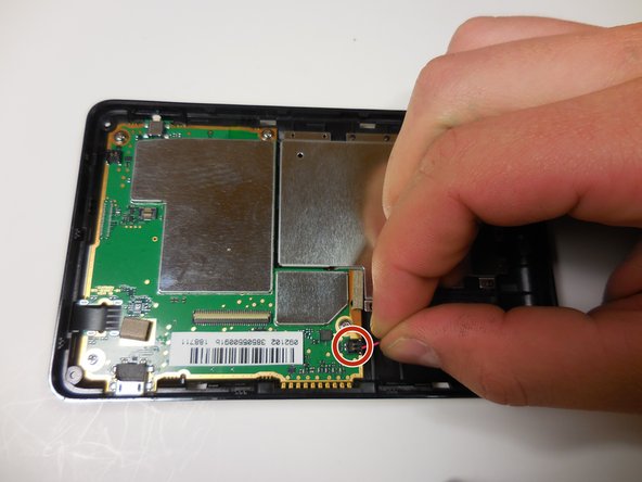

  11. Garmin nüvi 3590 LMT Speaker Replacement: crwdns2935265:011crwdnd2935265:01crwdnd2935265:03crwdne2935265:0 Garmin nüvi 3590 LMT Speaker Replacement: crwdns2935265:011crwdnd2935265:02crwdnd2935265:03crwdne2935265:0 Garmin nüvi 3590 LMT Speaker Replacement: crwdns2935265:011crwdnd2935265:03crwdnd2935265:03crwdne2935265:0

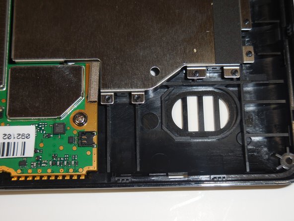

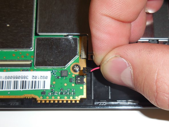

    • Locate the red and black wire that connects the speaker to the circuit board. Use your fingers (or tweezers) to gently lift the plug off the circuit board.

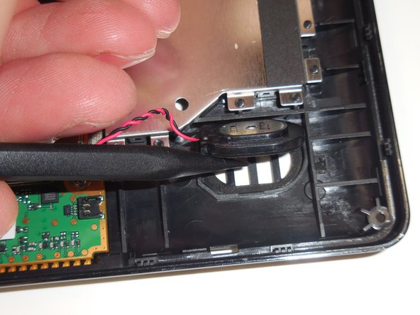

  12. Garmin nüvi 3590 LMT Speaker Replacement: crwdns2935265:012crwdnd2935265:01crwdnd2935265:03crwdne2935265:0 Garmin nüvi 3590 LMT Speaker Replacement: crwdns2935265:012crwdnd2935265:02crwdnd2935265:03crwdne2935265:0 Garmin nüvi 3590 LMT Speaker Replacement: crwdns2935265:012crwdnd2935265:03crwdnd2935265:03crwdne2935265:0
    • With the plastic spudger, lift the speaker up and out of the frame.
