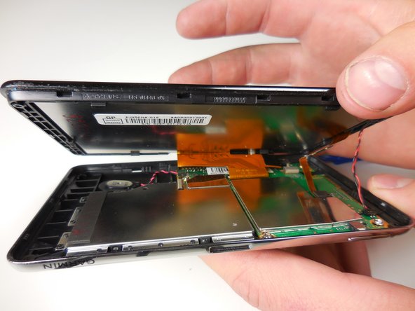

  7. Garmin nüvi 3590 LMT Light Sensor Replacement: crwdns2935265:07crwdnd2935265:01crwdnd2935265:03crwdne2935265:0 Garmin nüvi 3590 LMT Light Sensor Replacement: crwdns2935265:07crwdnd2935265:02crwdnd2935265:03crwdne2935265:0 Garmin nüvi 3590 LMT Light Sensor Replacement: crwdns2935265:07crwdnd2935265:03crwdnd2935265:03crwdne2935265:0
    • Leverage the plastic opening tool to pop the tabs between the black screen and the metal frame around the perimeter of the device.
    • Do not forcibly separate the two pieces after the tabs have been popped as there are connections between the two pieces that could be torn.

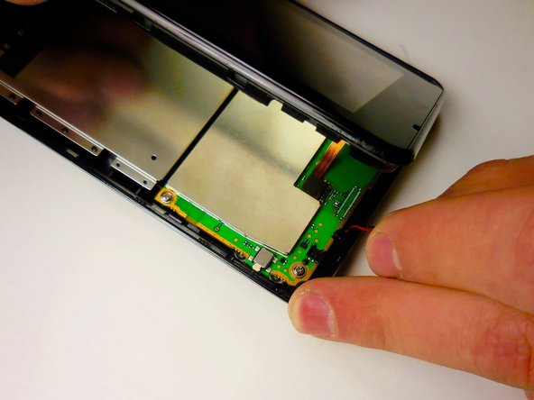

  8. Garmin nüvi 3590 LMT Light Sensor Replacement: crwdns2935265:08crwdnd2935265:01crwdnd2935265:02crwdne2935265:0 Garmin nüvi 3590 LMT Light Sensor Replacement: crwdns2935265:08crwdnd2935265:02crwdnd2935265:02crwdne2935265:0
    • Using your fingers, pull the red and black wire from the back of the screen.
  9. Garmin nüvi 3590 LMT Light Sensor Replacement: crwdns2935265:09crwdnd2935265:01crwdnd2935265:02crwdne2935265:0 Garmin nüvi 3590 LMT Light Sensor Replacement: crwdns2935265:09crwdnd2935265:02crwdnd2935265:02crwdne2935265:0
    • Locate the red and black wire connected to the circuit board with the round, black, rubbery disc that was connected to the other half of the device (that disc is the light sensor). Gently pull the wire up from the circuit board.
