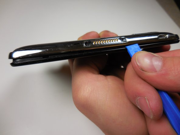

  2. Garmin nüvi 3590 LMT Glass Screen Replacement: crwdns2935265:02crwdnd2935265:01crwdnd2935265:01crwdne2935265:0
    • Use the plastic opening tool to separate the tabs on the black back cover of the device by leveraging the tool against the frame around the perimeter of the device.
  3. Garmin nüvi 3590 LMT Glass Screen Replacement: crwdns2935265:03crwdnd2935265:01crwdnd2935265:01crwdne2935265:0
    • Once all of the tabs are popped out, take the back cover off.
    • The back cover is a separate piece from the device.

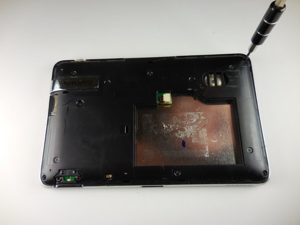

  6. Garmin nüvi 3590 LMT Glass Screen Replacement, Glass Screen: crwdns2935265:06crwdnd2935265:01crwdnd2935265:02crwdne2935265:0 Garmin nüvi 3590 LMT Glass Screen Replacement, Glass Screen: crwdns2935265:06crwdnd2935265:02crwdnd2935265:02crwdne2935265:0
    • Using the T5 bit, unscrew the four 5.7mm screws in the four corners on the back of the device.

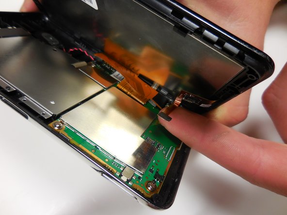

  7. Garmin nüvi 3590 LMT Glass Screen Replacement: crwdns2935265:07crwdnd2935265:01crwdnd2935265:03crwdne2935265:0 Garmin nüvi 3590 LMT Glass Screen Replacement: crwdns2935265:07crwdnd2935265:02crwdnd2935265:03crwdne2935265:0 Garmin nüvi 3590 LMT Glass Screen Replacement: crwdns2935265:07crwdnd2935265:03crwdnd2935265:03crwdne2935265:0
    • Use the plastic opening tool to leverage up on the tabs between the black screen and the metal frame.
    • Do not forcibly separate the two pieces after the tabs have been popped. There are connections between the two pieces that could be torn.

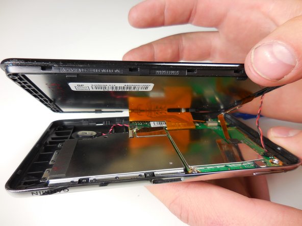

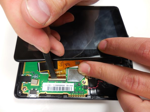

  8. Garmin nüvi 3590 LMT Glass Screen Replacement: crwdns2935265:08crwdnd2935265:01crwdnd2935265:02crwdne2935265:0 Garmin nüvi 3590 LMT Glass Screen Replacement: crwdns2935265:08crwdnd2935265:02crwdnd2935265:02crwdne2935265:0
    • Using your fingers, pull up on the red and black wire from the back of the screen.
    • This wire is part of the speaker, so be careful not to damage it.

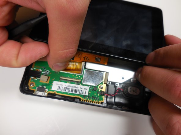

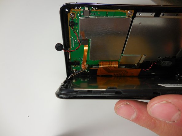

  9. Garmin nüvi 3590 LMT Glass Screen Replacement: crwdns2935265:09crwdnd2935265:01crwdnd2935265:02crwdne2935265:0 Garmin nüvi 3590 LMT Glass Screen Replacement: crwdns2935265:09crwdnd2935265:02crwdnd2935265:02crwdne2935265:0
    • Pull up on the smaller orange tab with your finger from the circuit board.
  10. Garmin nüvi 3590 LMT Glass Screen Replacement: crwdns2935265:010crwdnd2935265:01crwdnd2935265:03crwdne2935265:0 Garmin nüvi 3590 LMT Glass Screen Replacement: crwdns2935265:010crwdnd2935265:02crwdnd2935265:03crwdne2935265:0 Garmin nüvi 3590 LMT Glass Screen Replacement: crwdns2935265:010crwdnd2935265:03crwdnd2935265:03crwdne2935265:0
    • For the larger orange connection, there is a white tab holding the connection to the circuit board.
    • Lift the white tab gently with the plastic spudger and remove the orange connection from the circuit board.

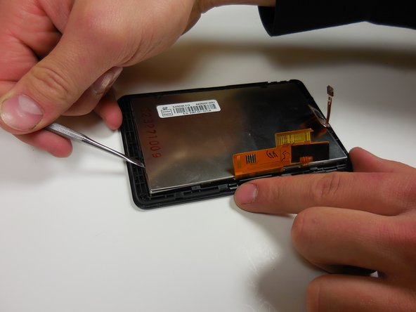

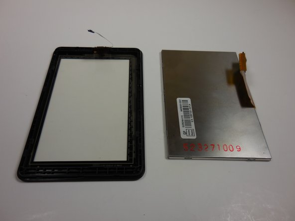

  11. Garmin nüvi 3590 LMT Glass Screen Replacement: crwdns2935265:011crwdnd2935265:01crwdnd2935265:03crwdne2935265:0 Garmin nüvi 3590 LMT Glass Screen Replacement: crwdns2935265:011crwdnd2935265:02crwdnd2935265:03crwdne2935265:0 Garmin nüvi 3590 LMT Glass Screen Replacement: crwdns2935265:011crwdnd2935265:03crwdnd2935265:03crwdne2935265:0
    • Use the metal spudger to leverage and lift the metal board from the glass paneling around the perimeter of the device.
    • Be careful to not damage any connections.
