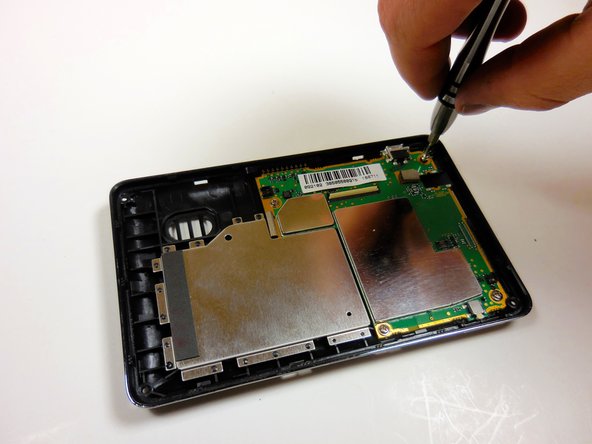

    • Using the T5 bit, unscrew the four 5.7mm screws in the four corners of the device.

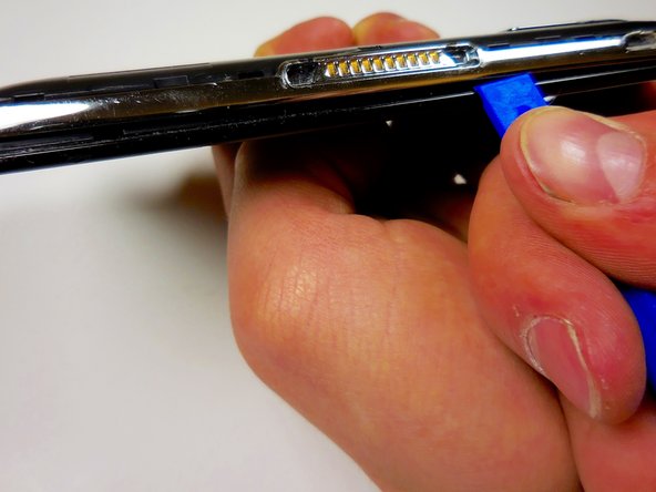

  7. Garmin nüvi 3590 LMT Circuit Board Replacement: crwdns2935265:07crwdnd2935265:01crwdnd2935265:03crwdne2935265:0 Garmin nüvi 3590 LMT Circuit Board Replacement: crwdns2935265:07crwdnd2935265:02crwdnd2935265:03crwdne2935265:0 Garmin nüvi 3590 LMT Circuit Board Replacement: crwdns2935265:07crwdnd2935265:03crwdnd2935265:03crwdne2935265:0

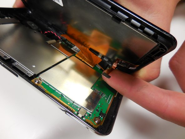

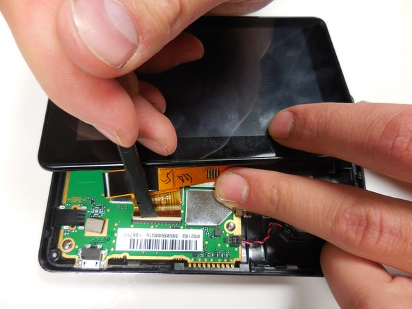

    • Leverage the plastic opening tool to pop the tabs between the black screen and the metal frame around the perimeter of the device.
    • Do not forcibly separate the two pieces after the tabs have been popped as there are connections between the two pieces that could be torn.

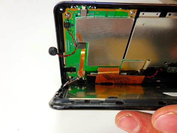

  8. Garmin nüvi 3590 LMT Circuit Board Replacement: crwdns2935265:08crwdnd2935265:01crwdnd2935265:02crwdne2935265:0 Garmin nüvi 3590 LMT Circuit Board Replacement: crwdns2935265:08crwdnd2935265:02crwdnd2935265:02crwdne2935265:0
    • Using your fingers, remove the red and black wire from the back of the screen.
  9. Garmin nüvi 3590 LMT Circuit Board Replacement: crwdns2935265:09crwdnd2935265:01crwdnd2935265:02crwdne2935265:0 Garmin nüvi 3590 LMT Circuit Board Replacement: crwdns2935265:09crwdnd2935265:02crwdnd2935265:02crwdne2935265:0

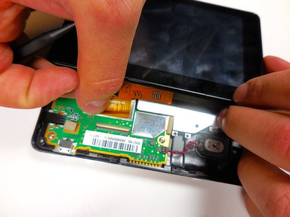

    • Pull up on the smaller orange tab with your finger from the circuit board.
  10. Garmin nüvi 3590 LMT Circuit Board Replacement: crwdns2935265:010crwdnd2935265:01crwdnd2935265:03crwdne2935265:0 Garmin nüvi 3590 LMT Circuit Board Replacement: crwdns2935265:010crwdnd2935265:02crwdnd2935265:03crwdne2935265:0 Garmin nüvi 3590 LMT Circuit Board Replacement: crwdns2935265:010crwdnd2935265:03crwdnd2935265:03crwdne2935265:0
    • For the larger orange connection, there is a white tab holding the connection to the circuit board.
    • Lift this tab gently with the wider tipped tweezers or the plastic spudger and remove the orange connection from the circuit board.

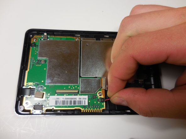

  11. Garmin nüvi 3590 LMT Circuit Board Replacement: crwdns2935265:011crwdnd2935265:01crwdnd2935265:01crwdne2935265:0

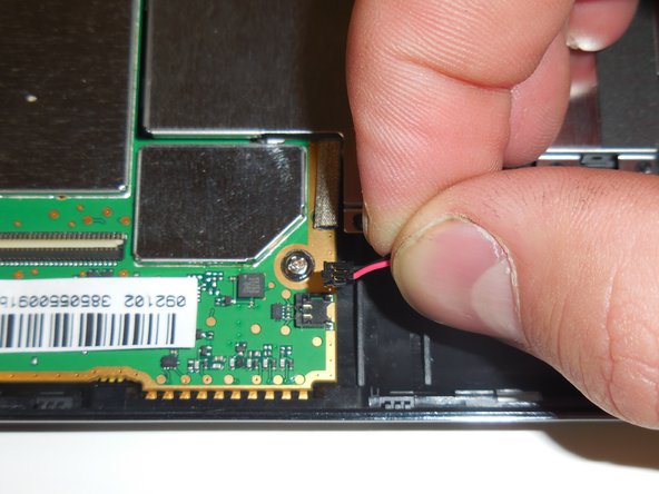

    • Locate the red and black wire connected to the logic board with the round, black, rubber disc that connects to the other half of the device. Gently pull the wire up from the logic board.
  12. Garmin nüvi 3590 LMT Circuit Board Replacement: crwdns2935265:012crwdnd2935265:01crwdnd2935265:03crwdne2935265:0 Garmin nüvi 3590 LMT Circuit Board Replacement: crwdns2935265:012crwdnd2935265:02crwdnd2935265:03crwdne2935265:0 Garmin nüvi 3590 LMT Circuit Board Replacement: crwdns2935265:012crwdnd2935265:03crwdnd2935265:03crwdne2935265:0
    • Separate the connection between the speaker and the logic board by gently pulling the wire up.

    • Using the J000 bit, unscrew the four 4.0 mm screws from the corners of the logic board.

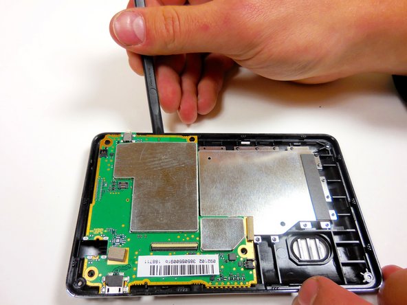

  14. Garmin nüvi 3590 LMT Circuit Board Replacement: crwdns2935265:014crwdnd2935265:01crwdnd2935265:03crwdne2935265:0 Garmin nüvi 3590 LMT Circuit Board Replacement: crwdns2935265:014crwdnd2935265:02crwdnd2935265:03crwdne2935265:0 Garmin nüvi 3590 LMT Circuit Board Replacement: crwdns2935265:014crwdnd2935265:03crwdnd2935265:03crwdne2935265:0

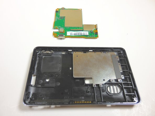

    • Starting near the power button, leverage the spudger to pry up the logic board around the perimeter of the frame.
