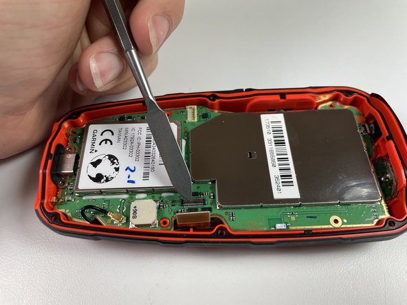

  5. Garmin inReach Explorer Plus Button Pad Replacement: crwdns2935265:05crwdnd2935265:01crwdnd2935265:02crwdne2935265:0 Garmin inReach Explorer Plus Button Pad Replacement: crwdns2935265:05crwdnd2935265:02crwdnd2935265:02crwdne2935265:0
    • Disconnect the LCD screen from the motherboard by lifting on the flap with the nylon spudger.
    • The metal spudger should only be used for serious prying power. If used incorrectly, the metal spudger may damage the components of a device.

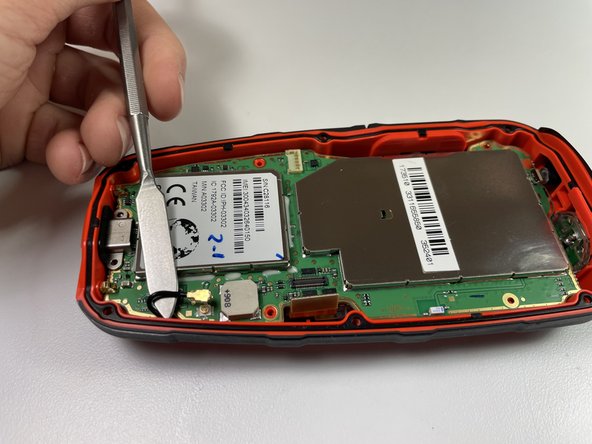

  6. Garmin inReach Explorer Plus Button Pad Replacement: crwdns2935265:06crwdnd2935265:01crwdnd2935265:02crwdne2935265:0 Garmin inReach Explorer Plus Button Pad Replacement: crwdns2935265:06crwdnd2935265:02crwdnd2935265:02crwdne2935265:0
    • Disconnect the antenna from the motherboard by lifting the wire with a nylon spudger.

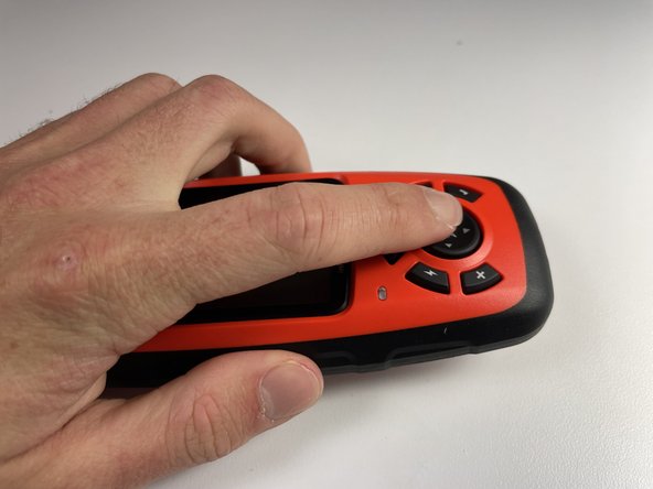

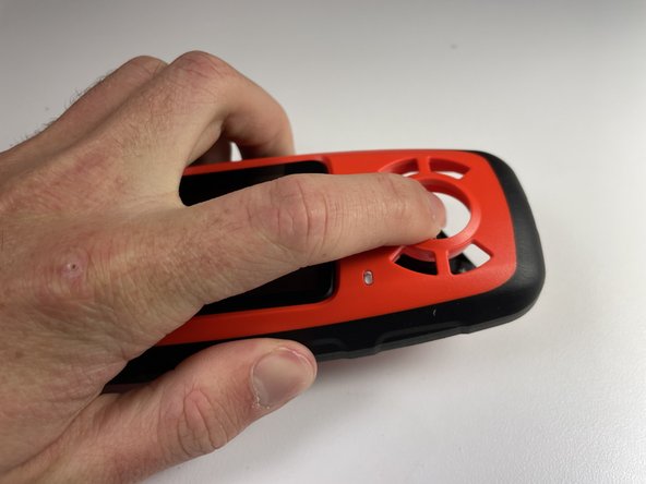

    • After the motherboard is removed, make sure the wire is out of the way of the button pad.
    • Flip the device over and push down on the button pad to remove it from the device.
