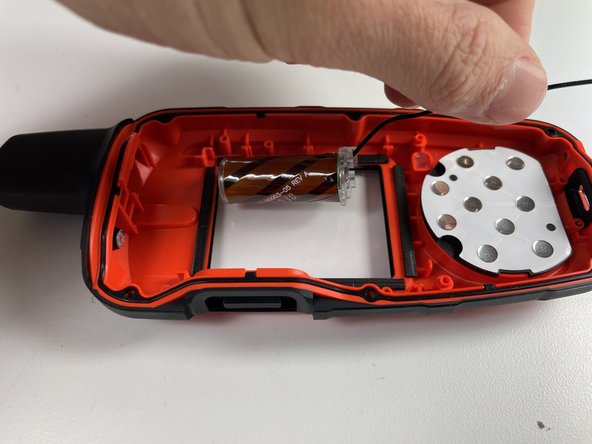

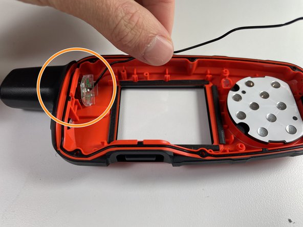

  10. Garmin inReach Explorer Plus Antenna Replacement, Antenna: crwdns2935265:010crwdnd2935265:01crwdnd2935265:03crwdne2935265:0 Garmin inReach Explorer Plus Antenna Replacement, Antenna: crwdns2935265:010crwdnd2935265:02crwdnd2935265:03crwdne2935265:0 Garmin inReach Explorer Plus Antenna Replacement, Antenna: crwdns2935265:010crwdnd2935265:03crwdnd2935265:03crwdne2935265:0
    • Gently pull out the antenna wire and remove the antenna from the device.
    • The antenna should now slide out easily. If the antenna is stuck, use the spudger to gently dislodge the antenna from its housing.
