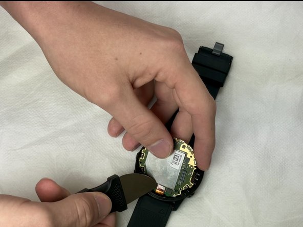

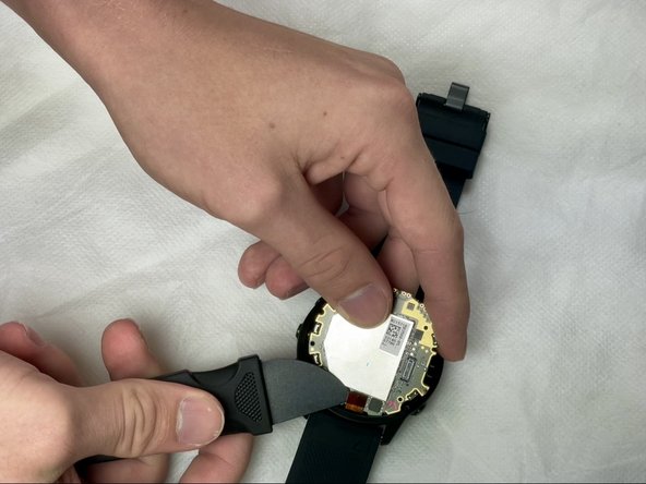

  3. Garmin fenix 6X Sapphire Motherboard Replacement, Motherboard: crwdns2935265:03crwdnd2935265:01crwdnd2935265:01crwdne2935265:0
    • Remove the four 5mm silver screws on the outer part of the motherboard using the T5 Torx screwdriver.
    • Pull the motherboard out carefully as it is connected on the other side by another ribbon connector.
  4. Garmin fenix 6X Sapphire Motherboard Replacement: crwdns2935265:04crwdnd2935265:01crwdnd2935265:03crwdne2935265:0 Garmin fenix 6X Sapphire Motherboard Replacement: crwdns2935265:04crwdnd2935265:02crwdnd2935265:03crwdne2935265:0 Garmin fenix 6X Sapphire Motherboard Replacement: crwdns2935265:04crwdnd2935265:03crwdnd2935265:03crwdne2935265:0
    • Unlock the ZIF connector and remove the ribbon connector from the back of the motherboard.
    • A Jimmy can be used if you have trouble prying the piece with your fingers.
    • Be careful not to pull on the ribbon as it could tear.
    • Remove the motherboard.
