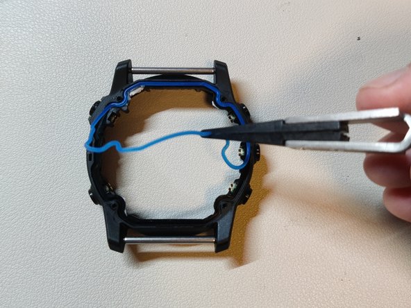

  8. Garmin fēnix 7X Teardown, Before re-installing the back plate, re-install back plate gasket: crwdns2935265:09crwdnd2935265:01crwdnd2935265:03crwdne2935265:0 Garmin fēnix 7X Teardown, Before re-installing the back plate, re-install back plate gasket: crwdns2935265:09crwdnd2935265:02crwdnd2935265:03crwdne2935265:0 Garmin fēnix 7X Teardown, Before re-installing the back plate, re-install back plate gasket: crwdns2935265:09crwdnd2935265:03crwdnd2935265:03crwdne2935265:0
    • Before re-installing the back plate, re-install the back plate gasket.
    • It's possible for the gasket to stick to the back plate during the removal of the back plate. If this occurs, remove the gasket from the back plate.
    • Locate the groove on the bottom of the watch body and press the gasket into it. The gasket and groove are not symmetrical so be sure to orient the gasket correctly.
  9. Garmin fēnix 7X Teardown, Before re-installing the screen assembly, re-install the screen assembly gasket: crwdns2935265:010crwdnd2935265:01crwdnd2935265:02crwdne2935265:0 Garmin fēnix 7X Teardown, Before re-installing the screen assembly, re-install the screen assembly gasket: crwdns2935265:010crwdnd2935265:02crwdnd2935265:02crwdne2935265:0
    • If the screen assembly gasket came loose during removal of the assembly, press it back into the groove on the underside of the screen assembly.
