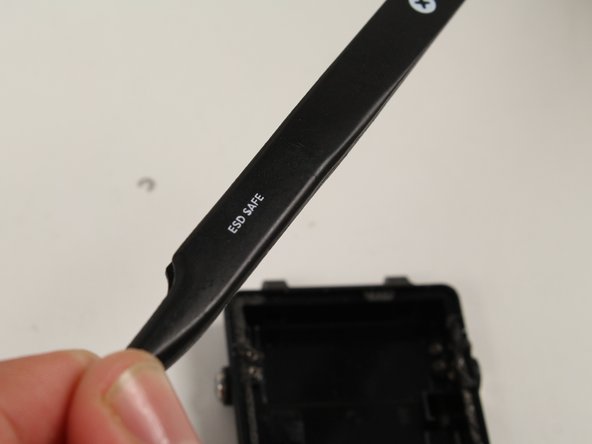

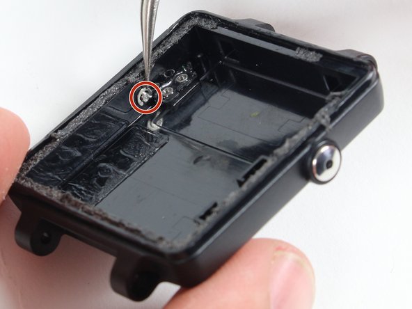

  15. Garmin Vivoactive Side Button Replacement, Side Button: crwdns2935265:015crwdnd2935265:01crwdnd2935265:03crwdne2935265:0 Garmin Vivoactive Side Button Replacement, Side Button: crwdns2935265:015crwdnd2935265:02crwdnd2935265:03crwdne2935265:0 Garmin Vivoactive Side Button Replacement, Side Button: crwdns2935265:015crwdnd2935265:03crwdnd2935265:03crwdne2935265:0
    • Orient the crescent shaped retaining clip so the open section faces the bottom of the device.
    • Remove the retaining clip by pulling up away from the device with the precision tweezers.
    • Be careful, the tweezers are quite sharp!

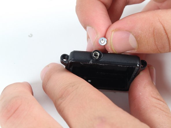

  16. Garmin Vivoactive Side Button Replacement: crwdns2935265:016crwdnd2935265:01crwdnd2935265:02crwdne2935265:0 Garmin Vivoactive Side Button Replacement: crwdns2935265:016crwdnd2935265:02crwdnd2935265:02crwdne2935265:0
    • After the retaining clip is removed, the spring and button will pop out.
    • With these very small components free from your device, take care not to lose them.
    • The spring is slightly compressed, so the button may pop out once the clip is removed.
