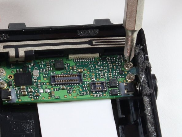

    1. Garmin Vivoactive Motherboard Replacement, Motherboard: crwdns2935265:012crwdnd2935265:01crwdnd2935265:02crwdne2935265:0 Garmin Vivoactive Motherboard Replacement, Motherboard: crwdns2935265:012crwdnd2935265:02crwdnd2935265:02crwdne2935265:0
      • Remove the four 2.4 mm screws with a PH00 Phillips head screwdriver.
      • Make an effort not to damage any nearby components of the motherboard with the screwdriver.
    2. Garmin Vivoactive Motherboard Replacement: crwdns2935265:013crwdnd2935265:01crwdnd2935265:02crwdne2935265:0 Garmin Vivoactive Motherboard Replacement: crwdns2935265:013crwdnd2935265:02crwdnd2935265:02crwdne2935265:0
      • Use the spudger to pry up the board from the case.
      • Insert the spudger a minimum distance beneath the board as there are components below.
      • Wiggle the exposed side of the board from each end until it comes free.
      • Use proper electrostatic discharge safety when removing and handling the board.

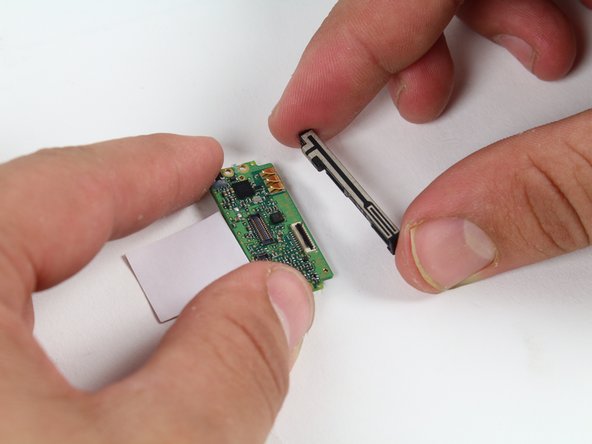

    3. Garmin Vivoactive Motherboard Replacement: crwdns2935265:014crwdnd2935265:01crwdnd2935265:02crwdne2935265:0 Garmin Vivoactive Motherboard Replacement: crwdns2935265:014crwdnd2935265:02crwdnd2935265:02crwdne2935265:0
      • Remove the GPS antenna by sliding it away from the board.
      • Keep track of the antenna and add it to the new board upon replacement.
