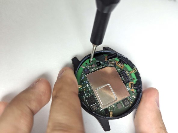

      • Use a Phillips #00 screwdriver to remove the 3.2 mm screw on the motherboard.
      • Use a Phillips #00 screwdriver to remove the 4.8 mm screw on the motherboard.

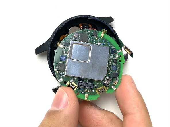

    4. Garmin Vívoactive 4 Button Replacement: crwdns2935265:011crwdnd2935265:01crwdnd2935265:03crwdne2935265:0 Garmin Vívoactive 4 Button Replacement: crwdns2935265:011crwdnd2935265:02crwdnd2935265:03crwdne2935265:0 Garmin Vívoactive 4 Button Replacement: crwdns2935265:011crwdnd2935265:03crwdnd2935265:03crwdne2935265:0
      • Pull the battery cable up to dislodge the motherboard.
      • Gently remove the motherboard from the socket.
      • The motherboard may get caught under the housing due to the clips on the edge.

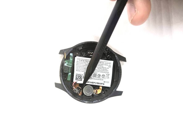

    1. Garmin Vívoactive 4 Button Replacement, Battery: crwdns2935265:012crwdnd2935265:01crwdnd2935265:02crwdne2935265:0 Garmin Vívoactive 4 Button Replacement, Battery: crwdns2935265:012crwdnd2935265:02crwdnd2935265:02crwdne2935265:0
      • Use the pointed tip of a spudger to carefully push on each side of the battery connector to disconnect the battery from the motherboard.
    2. Garmin Vívoactive 4 Button Replacement: crwdns2935265:013crwdnd2935265:01crwdnd2935265:03crwdne2935265:0 Garmin Vívoactive 4 Button Replacement: crwdns2935265:013crwdnd2935265:02crwdnd2935265:03crwdne2935265:0 Garmin Vívoactive 4 Button Replacement: crwdns2935265:013crwdnd2935265:03crwdnd2935265:03crwdne2935265:0
      • Use a spudger to pry the battery from the case.
      • Be careful not to damage any surrounding components.
      • There is an adhesive holding the battery down. Use an iOpener if it is too difficult to remove the battery with the spudger alone.

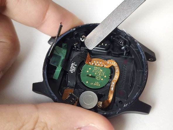

    1. Garmin Vívoactive 4 Button Replacement, Button: crwdns2935265:014crwdnd2935265:01crwdnd2935265:03crwdne2935265:0 Garmin Vívoactive 4 Button Replacement, Button: crwdns2935265:014crwdnd2935265:02crwdnd2935265:03crwdne2935265:0 Garmin Vívoactive 4 Button Replacement, Button: crwdns2935265:014crwdnd2935265:03crwdnd2935265:03crwdne2935265:0
      • Wedge a spudger or your iFixit Jimmy in between the button's snap ring and the watch housing.
      • Carefully pry the snap ring off the button.
      • Remove the button and components from the watch housing.
