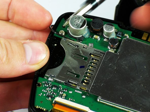

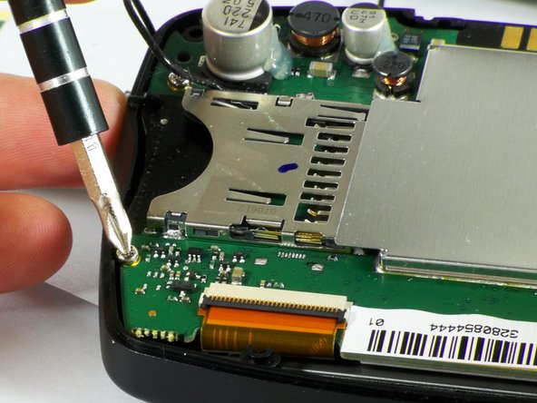

  6. Garmin StreetPilot c330 Screen Replacement, Screen: crwdns2935265:06crwdnd2935265:01crwdnd2935265:03crwdne2935265:0 Garmin StreetPilot c330 Screen Replacement, Screen: crwdns2935265:06crwdnd2935265:02crwdnd2935265:03crwdne2935265:0 Garmin StreetPilot c330 Screen Replacement, Screen: crwdns2935265:06crwdnd2935265:03crwdnd2935265:03crwdne2935265:0
    • Remove the three screws holding the motherboard in place.
  7. Garmin StreetPilot c330 Screen Replacement: crwdns2935265:07crwdnd2935265:01crwdnd2935265:01crwdne2935265:0
    • Use the spudger to lift up the motherboard.
  8. Garmin StreetPilot c330 Screen Replacement: crwdns2935265:08crwdnd2935265:01crwdnd2935265:03crwdne2935265:0 Garmin StreetPilot c330 Screen Replacement: crwdns2935265:08crwdnd2935265:02crwdnd2935265:03crwdne2935265:0 Garmin StreetPilot c330 Screen Replacement: crwdns2935265:08crwdnd2935265:03crwdnd2935265:03crwdne2935265:0
    • To remove the ribbon cable, lift the black latch using the spudger tool.
    • Separate the connection using either your fingers, tweezers, or the spudger.
