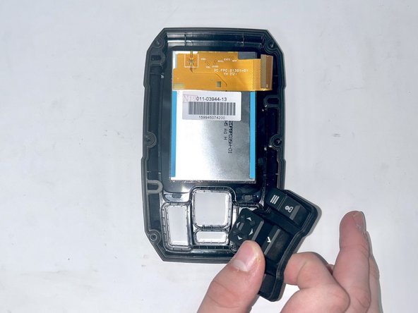

    1. Garmin STRIKER 4 Silicon Buttons Replacement, Silicon Buttons: crwdns2935265:04crwdnd2935265:01crwdnd2935265:02crwdne2935265:0 Garmin STRIKER 4 Silicon Buttons Replacement, Silicon Buttons: crwdns2935265:04crwdnd2935265:02crwdnd2935265:02crwdne2935265:0
      • Use the iFixit opening tool to lift the silicon buttons from their original casing.
