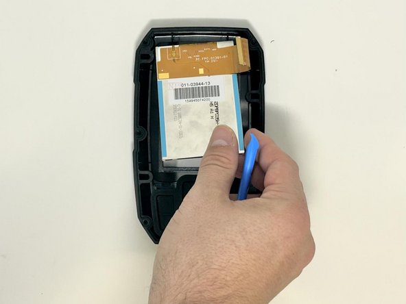

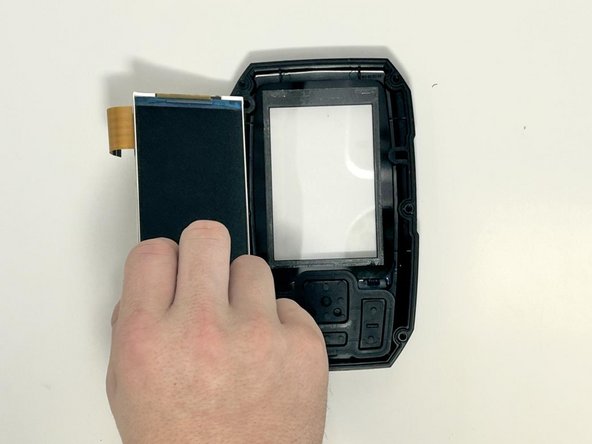

    1. Garmin STRIKER 4 Digital Display Replacement, Digital Display: crwdns2935265:04crwdnd2935265:01crwdnd2935265:03crwdne2935265:0 Garmin STRIKER 4 Digital Display Replacement, Digital Display: crwdns2935265:04crwdnd2935265:02crwdnd2935265:03crwdne2935265:0 Garmin STRIKER 4 Digital Display Replacement, Digital Display: crwdns2935265:04crwdnd2935265:03crwdnd2935265:03crwdne2935265:0
      • Use the iFixit opening tool to gently lift the screen from the casing.
