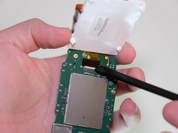

  6. Garmin Rino 700 Screen Replacement, Screen: crwdns2935265:06crwdnd2935265:01crwdnd2935265:03crwdne2935265:0 Garmin Rino 700 Screen Replacement, Screen: crwdns2935265:06crwdnd2935265:02crwdnd2935265:03crwdne2935265:0 Garmin Rino 700 Screen Replacement, Screen: crwdns2935265:06crwdnd2935265:03crwdnd2935265:03crwdne2935265:0
    • Carefully detach the screen at the bottom connections using your hands to reveal the ribbon connection.
    • For a guide on disconnecting and reconnecting the Zero Insertion Force (ZIF) connectors, please visit this guide.
