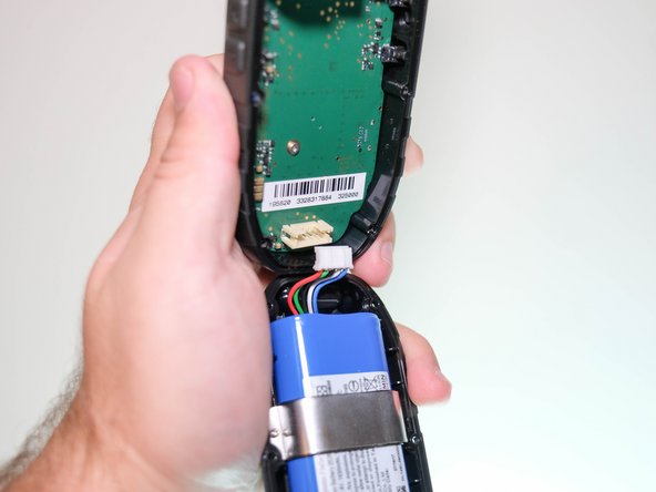

    • Remove the battery cover and set it to the side.
  3. Garmin Rino 700 Satellite Antenna Replacement: crwdns2935265:03crwdnd2935265:01crwdnd2935265:02crwdne2935265:0 Garmin Rino 700 Satellite Antenna Replacement: crwdns2935265:03crwdnd2935265:02crwdnd2935265:02crwdne2935265:0
    • Use the spudger to disconnect the battery wire port from the motherboard.

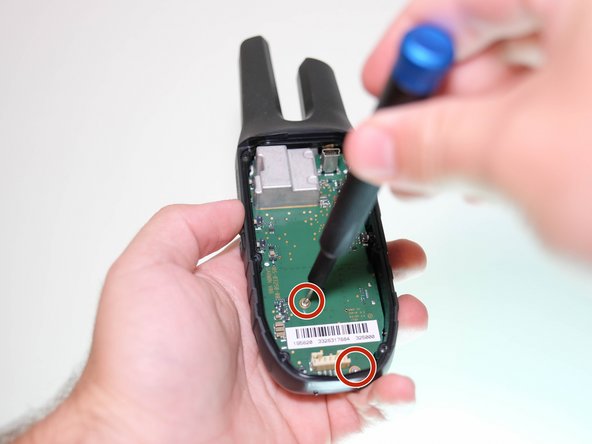

  4. Garmin Rino 700 Satellite Antenna Replacement, Motherboard: crwdns2935265:04crwdnd2935265:01crwdnd2935265:02crwdne2935265:0 Garmin Rino 700 Satellite Antenna Replacement, Motherboard: crwdns2935265:04crwdnd2935265:02crwdnd2935265:02crwdne2935265:0
    • Using the T5 Torx screwdriver, remove the two 6.4 mm screws on the motherboard.

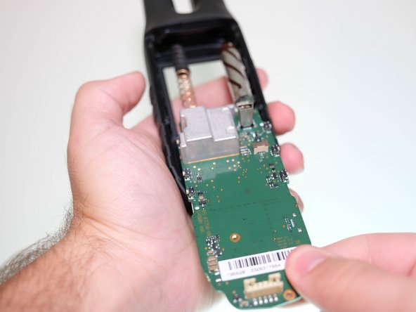

  5. Garmin Rino 700 Satellite Antenna Replacement: crwdns2935265:05crwdnd2935265:01crwdnd2935265:03crwdne2935265:0 Garmin Rino 700 Satellite Antenna Replacement: crwdns2935265:05crwdnd2935265:02crwdnd2935265:03crwdne2935265:0 Garmin Rino 700 Satellite Antenna Replacement: crwdns2935265:05crwdnd2935265:03crwdnd2935265:03crwdne2935265:0
    • Using the nylon spudger, lift the motherboard out of its position.
    • Slide the motherboard out of the front panel of the device.
    • Carefully disconnect the motherboard from the panel and remove it out of the device.

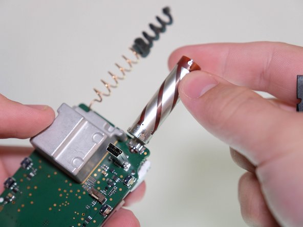

  6. Garmin Rino 700 Satellite Antenna Replacement, Satellite Antenna: crwdns2935265:06crwdnd2935265:01crwdnd2935265:03crwdne2935265:0 Garmin Rino 700 Satellite Antenna Replacement, Satellite Antenna: crwdns2935265:06crwdnd2935265:02crwdnd2935265:03crwdne2935265:0 Garmin Rino 700 Satellite Antenna Replacement, Satellite Antenna: crwdns2935265:06crwdnd2935265:03crwdnd2935265:03crwdne2935265:0
    • Gently and delicately heat up the solder holding the antenna port to the motherboard.
    • Carefully remove the antenna with the tweezers and set it aside.
    • Refer to the How To Solder and Desolder Connections for a guide on soldering.
