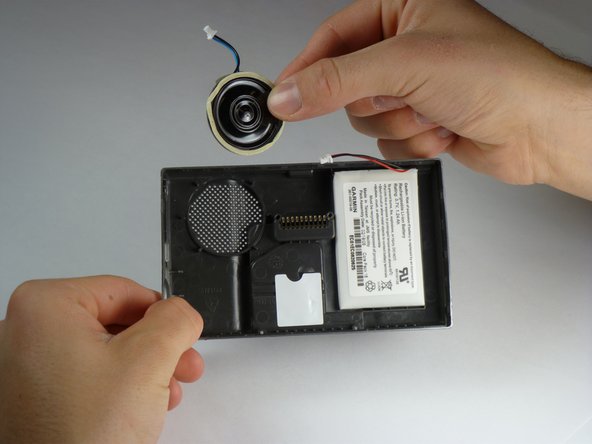

  12. Garmin Nuvi 680 Speaker Replacement: crwdns2935265:012crwdnd2935265:01crwdnd2935265:01crwdne2935265:0
    • Gently unplug the cable for the battery. It has a red and black cable.
    • Pull it straight up and away from the motherboard.
    • Gently unplug the cable for the speaker. It has a blue and black cable.
  13. Garmin Nuvi 680 Speaker Replacement: crwdns2935265:013crwdnd2935265:01crwdnd2935265:01crwdne2935265:0
    • Gently lift the motherboard straight up and out of the outer case.
    • There should be no wires attached to it.
  14. Garmin Nuvi 680 Speaker Replacement, Speaker: crwdns2935265:014crwdnd2935265:01crwdnd2935265:02crwdne2935265:0 Garmin Nuvi 680 Speaker Replacement, Speaker: crwdns2935265:014crwdnd2935265:02crwdnd2935265:02crwdne2935265:0
    • Use a spudger to gently pry the speaker out of its slot.
    • Remove the speaker.
