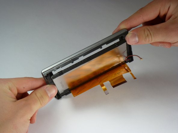

  10. Garmin Nuvi 680 Screen Replacement, Screen: crwdns2935265:010crwdnd2935265:01crwdnd2935265:02crwdne2935265:0 Garmin Nuvi 680 Screen Replacement, Screen: crwdns2935265:010crwdnd2935265:02crwdnd2935265:02crwdne2935265:0
    • Push the tabs towards the outside of the case, the tabs are located as shown.
    • Push the screen out of the case after the tabs are loosened.
    • Slide the screen out of the cover.
