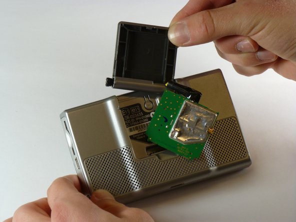

    • Locate the antenna on the back of the device and gently flip it open to reveal the screws underneath.
    • Remove the two 4.42 mm screws in the top-left and top-right corners of the antenna cover using a T5 Torx screwdriver
  2. Garmin Nuvi 680 Battery Replacement: crwdns2935265:02crwdnd2935265:01crwdnd2935265:01crwdne2935265:0
    • Remove the antenna cover.
    • Set the removed cover aside carefully.
  3. Garmin Nuvi 680 Battery Replacement: crwdns2935265:03crwdnd2935265:01crwdnd2935265:01crwdne2935265:0
    • The yellow wire is connected to the motherboard. Do not disconnect it until you finish opening the device.
    • Locate the green antenna circuit board in the middle of the case.
    • Gently use 1 or 2 fingers to grab and pull the antenna circuit board out of the middle of the case.
  4. Garmin Nuvi 680 Battery Replacement: crwdns2935265:04crwdnd2935265:01crwdnd2935265:02crwdne2935265:0 Garmin Nuvi 680 Battery Replacement: crwdns2935265:04crwdnd2935265:02crwdnd2935265:02crwdne2935265:0
    • Insert the pointed end of a spudger into the leftmost slit at the top of the antenna case, where you previously removed the circuit board
    • Once the spudger is inserted into the leftmost end of the slit at the top of the antenna case, slide it to the rightmost side of the slit.
    • Slide the antenna case out slowly or you may lose the antenna's spring. The spring is inside the black plastic that holds the antenna case to the device.
    • Slide the antenna case out of the device.
    • Reinstallation tip: first reassemble the antenna casing (place antenna back into its plastic cover), and then re-insert the entire assembly back into the GPS body.

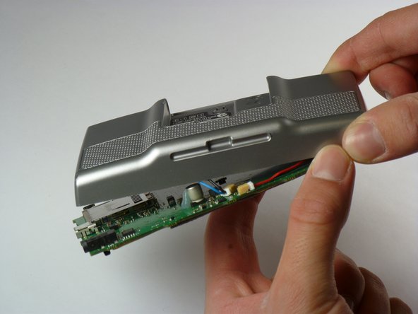

    • Locate the top side of the outer case.
    • Using your iFixit Opening Tool, gently insert a flat end of the tool into the slit of the top cover.
    • Use the Opening Tool and your hands to pull apart the front and back of the device. Grip the top and bottom sides with your hand while inserting the tool into the slit to gently separate the two halves
    • One end of the front and back of the outer case are still connected by ribbon cables.

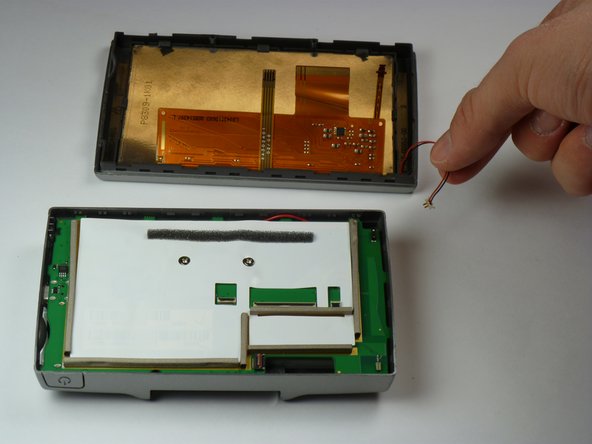

  8. Garmin Nuvi 680 Battery Replacement, Screen Wiring: crwdns2935265:08crwdnd2935265:01crwdnd2935265:01crwdne2935265:0
    • Do not remove the ribbon cables without lifting the latch or the cable will be damaged.
    • Lift the latches on the ribbon cable connectors. All the ribbon cables may have latches. The right most latch may have a latch that flips in the opposite direction from the others.
    • Gently pull the ribbon cables out of their connectors. They should slide out easily.
    • Do not separate the two halves of the device yet or the on/off cable may be severed.
  9. Garmin Nuvi 680 Battery Replacement: crwdns2935265:09crwdnd2935265:01crwdnd2935265:02crwdne2935265:0 Garmin Nuvi 680 Battery Replacement: crwdns2935265:09crwdnd2935265:02crwdnd2935265:02crwdne2935265:0
    • Gently pull the cable for the on/off button straight up to remove it.
    • The two halves of the device may now be separated.

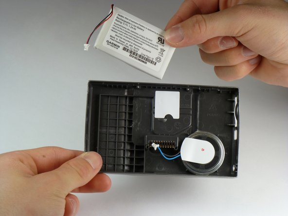

  14. Garmin Nuvi 680 Battery Replacement, Battery: crwdns2935265:014crwdnd2935265:01crwdnd2935265:02crwdne2935265:0 Garmin Nuvi 680 Battery Replacement, Battery: crwdns2935265:014crwdnd2935265:02crwdnd2935265:02crwdne2935265:0
    • The battery is difficult to remove because it's glued to the case.
    • Use a spudger to gently pry the battery out of its slot.
    • Remove the battery.
