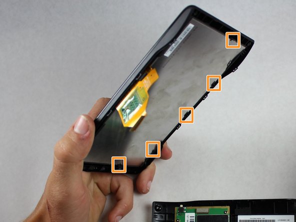

  4. Garmin Nuvi 65LM Screen Replacement, Screen: crwdns2935265:04crwdnd2935265:01crwdnd2935265:02crwdne2935265:0 Garmin Nuvi 65LM Screen Replacement, Screen: crwdns2935265:04crwdnd2935265:02crwdnd2935265:02crwdne2935265:0
    • Use the flat end the spudger to push back the casing clips that hold the screen onto the front casing.
    • Apply light pressure to the front of the screen as you push the casing clips back. This will keep the clips from clicking back into place.
    • Once all clips are pushed back, the screen will easily lift away from the front casing panel.
