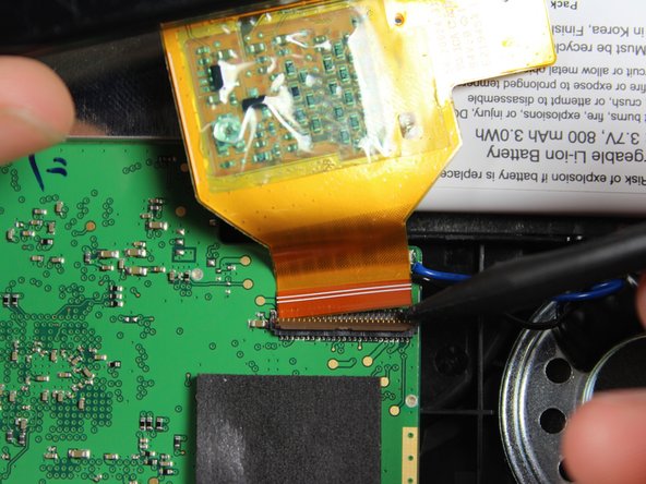

  3. Garmin Nuvi 65LM Battery Replacement: crwdns2935265:03crwdnd2935265:01crwdnd2935265:03crwdne2935265:0 Garmin Nuvi 65LM Battery Replacement: crwdns2935265:03crwdnd2935265:02crwdnd2935265:03crwdne2935265:0 Garmin Nuvi 65LM Battery Replacement: crwdns2935265:03crwdnd2935265:03crwdnd2935265:03crwdne2935265:0
    • Use a spudger to pop up the ZIF connector tab that fastens the ribbon cable to the motherboard.
    • Gently pull the front panel away and set it on your flat work surface.

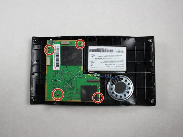

  4. Garmin Nuvi 65LM Battery Replacement, Battery: crwdns2935265:04crwdnd2935265:01crwdnd2935265:03crwdne2935265:0 Garmin Nuvi 65LM Battery Replacement, Battery: crwdns2935265:04crwdnd2935265:02crwdnd2935265:03crwdne2935265:0 Garmin Nuvi 65LM Battery Replacement, Battery: crwdns2935265:04crwdnd2935265:03crwdnd2935265:03crwdne2935265:0
    • Make sure the GPS is laying on a flat surface with the open side showing.
    • Unscrew the four marked 4.00 mm screws with a T5 torque screwdriver
    • Be sure to keep track of where you place the screws. A magnetic project mat works great for this.
    • Gently lift the motherboard off of the plastic casing.
    • The speaker and battery are still connected to the motherboard so do not pull the motherboard completely away from the casing.

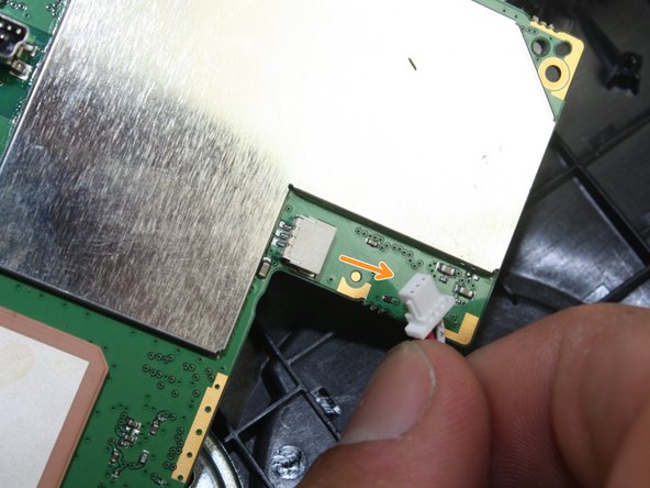

  5. Garmin Nuvi 65LM Battery Replacement: crwdns2935265:05crwdnd2935265:01crwdnd2935265:03crwdne2935265:0 Garmin Nuvi 65LM Battery Replacement: crwdns2935265:05crwdnd2935265:02crwdnd2935265:03crwdne2935265:0 Garmin Nuvi 65LM Battery Replacement: crwdns2935265:05crwdnd2935265:03crwdnd2935265:03crwdne2935265:0
    • Turn the motherboard over to find the plug which connects the battery to the motherboard.
    • Gently disconnect the plug by catching on the raised rib of the plug with your fingernail. Then pull the plug away from the connection.

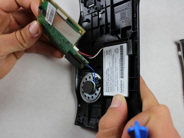

    • Using the flat end of the plastic opening tool carefully pry the battery and its adhesive away from the casing.
    • The adhesive holding the battery down is very strong. Prying the battery up may take some force but go slowly and carefully in order to avoid damaging the battery.
    • Once most of the adhesive is unstuck from the casing, use your hands to remove the battery completely.

Excellent guide! A little more detail about how the ZIP cable connection is made would add to this
leerw - crwdns2934203:0crwdne2934203:0
