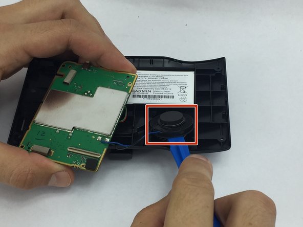

    • Once the screws are removed flip the motherboard over and locate the blue (+) and black (-) wires connected to the speaker.
  4. Garmin Nuvi 56LMT Speaker Replacement: crwdns2935265:04crwdnd2935265:01crwdnd2935265:02crwdne2935265:0 Garmin Nuvi 56LMT Speaker Replacement: crwdns2935265:04crwdnd2935265:02crwdnd2935265:02crwdne2935265:0
    • Use the crimping tool to cut the wires from the motherboard.
    • Use plastic opening tool or fingers to remove the speaker.
