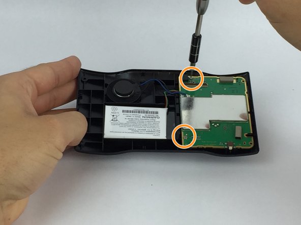

    • Use the plastic opening tool to carefully pry the battery from the case.
    • Then remove the 5mm screws that are present on the motherboard.

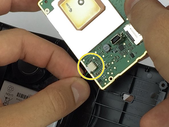

    • Disconnect the battery from the motherboard, by pinching the wires and pulling straight out.
