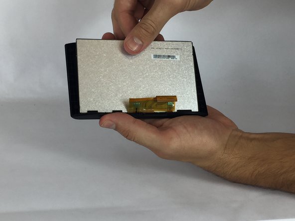

  5. Garmin Nuvi 56LMT Display Screen Replacement: crwdns2935265:05crwdnd2935265:01crwdnd2935265:02crwdne2935265:0 Garmin Nuvi 56LMT Display Screen Replacement: crwdns2935265:05crwdnd2935265:02crwdnd2935265:02crwdne2935265:0
    • With your fingers hold back each of the clips located around the border of the screens back.
    • Pull screen up and slide out in the opposite direction of the ribbon to avoid snapping the fixed clips.
